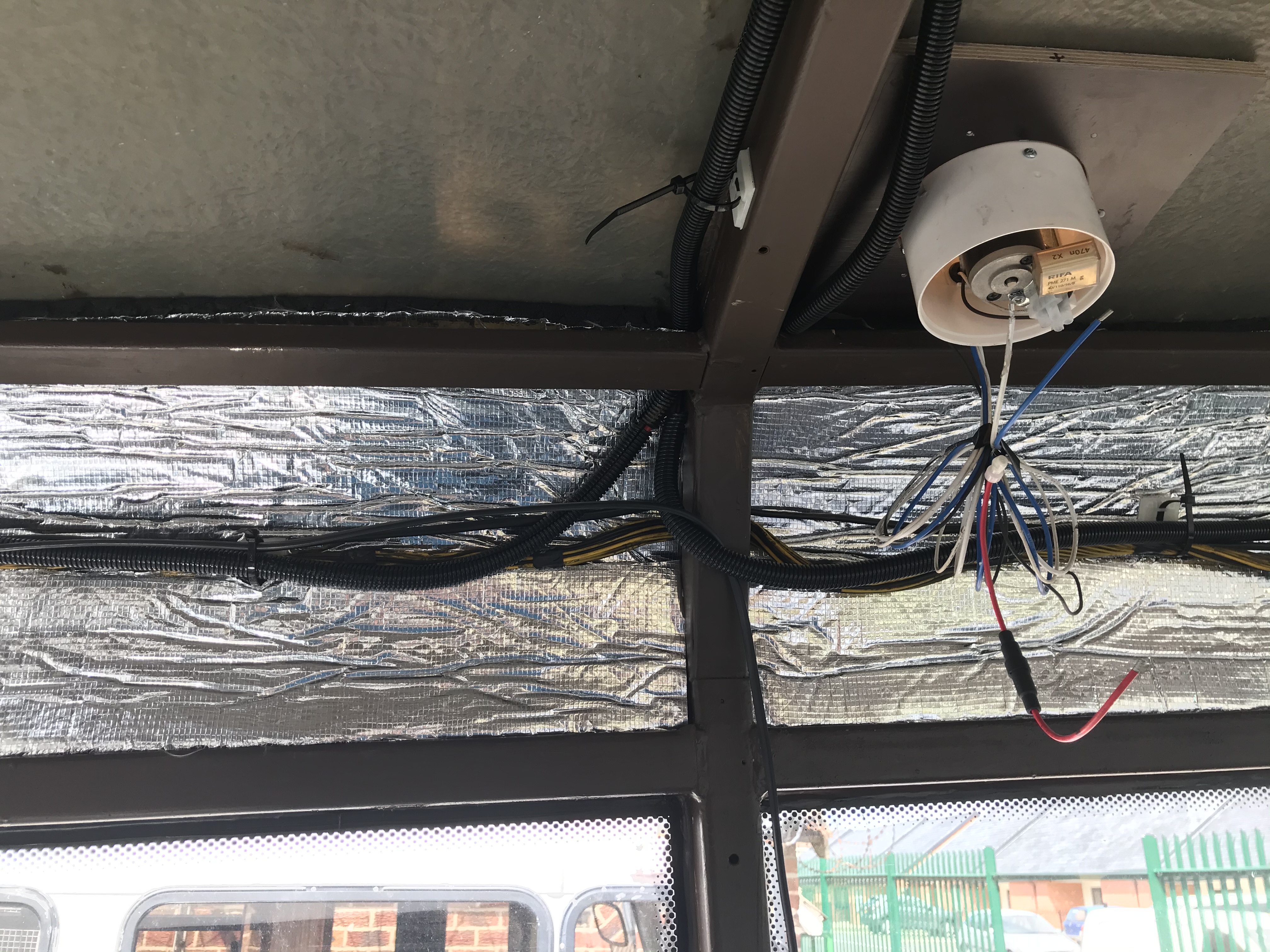

Thanks, looked at similar but wanted a thinner product. But that looks heavyweight and could do a job , where did you used it on your van?
It's a curved surface, so being flexible it makes it easier to fit. I also use it around the engine bulkhead to reduce noise.
