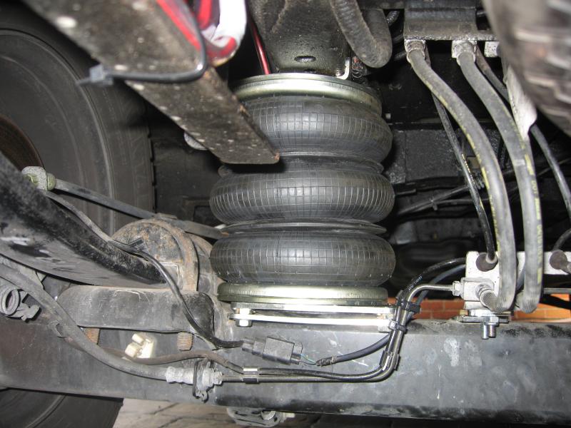

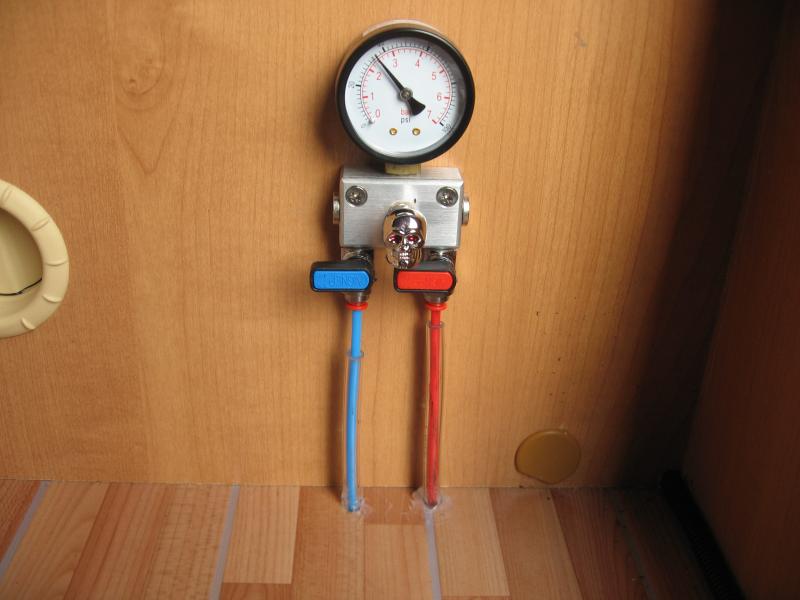

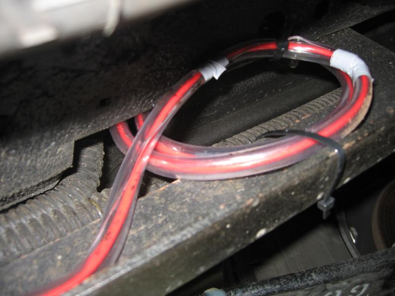

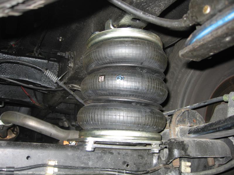

Here are some pictures of the air suspension that I've just fitted to our motorhome, it took me about 3-1/2hrs to do.
John.

....would be interested to know the make and model of motorhome (and weight)
.....also what benefits you feel you have gained
......and finally the damage sustained by your wallet!!!!
Thanks
Ian
Thanks
Ian
Ford Auto roller 100 with garage 3500kg.
Prevents body roll on roundabouts, Also when overtaking heavy goods vehicles. Leveling if one side is heavier than the other, levelling on uneven ground, also prevents rear springs sagging.
The other reason is personal choice.
Prices on the Marcle leisure site.
John.

It makes for a comfortable ride, the 'van is always level or slightly nose down and, depending on the load, a few swift strokes of a foot pump raises it. There's a gauge and an air valve just inside the habitation door for when I need to adjust it.
I've had it two years and done 22,000 miles and it's been fine. The brand is Air-ride and it was just over £500 fitted, but I suspect that you'd pay about £300 if you can do it yourself. You can get some that can be adjusted from a switch in the cab but I didn't feel that I needed that level of sophistication.

Hi Ian, I've taken the van out today for a decent run since fitting the air springs, the difference is unbelievable, road humps and ramps are a lot smoother, roundabouts no body roll.
The ones I've fitted are Dunlop and dearer than Northener paid 2 years ago.
Transit front wheel drive £546 basic kit.
£67 for seperate pressure gauge left handed, right handed, or bottom fitting.
