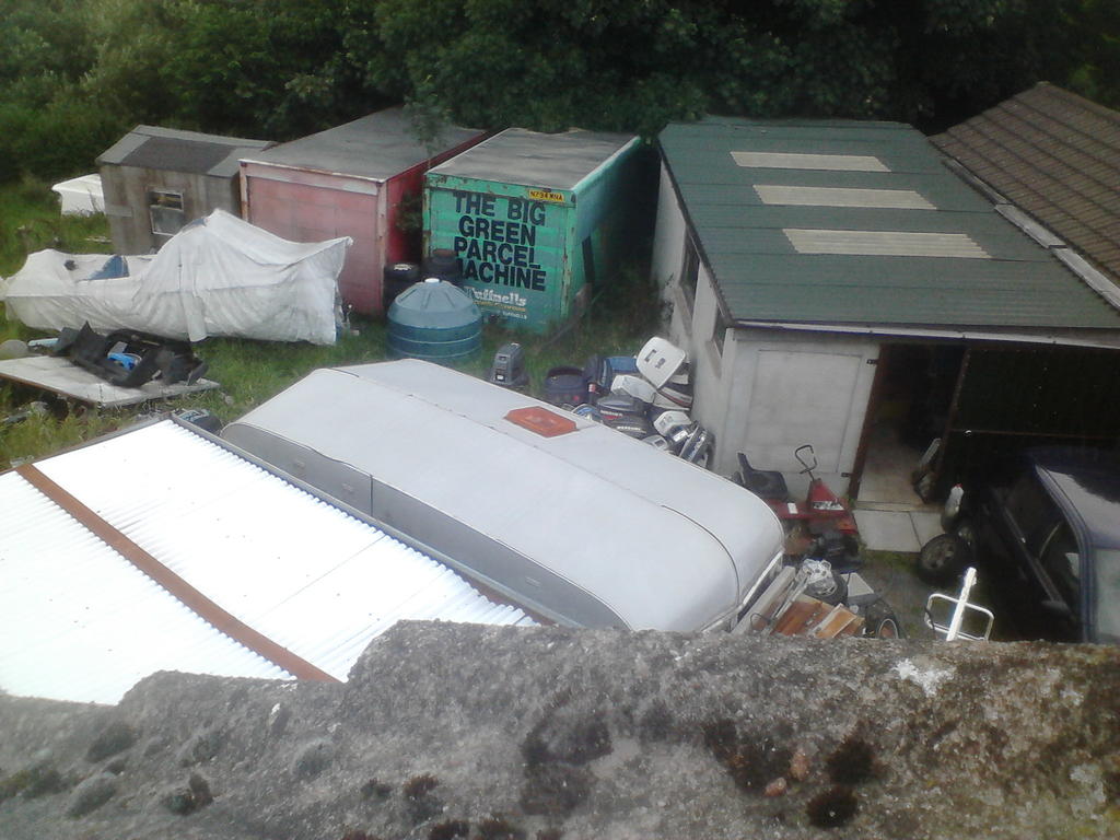

Ok the tin roof are ok but use the stuff with insulation or it will drip,then one clear g/f where solar panel is going to be under,my second workshop has the roof done this way.
