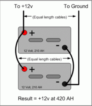

You could do a f glass box or buy a marine plastic box with a lid, make sure you are using sealed lead acid batts, you should have a drop out hole under the tray if open vented, my ex liberty bus had its battery in the passengers footwell with no dropout hole and it was open vent to boot, very dangerous from a bus converter, remember to join the bats like this if possable.
