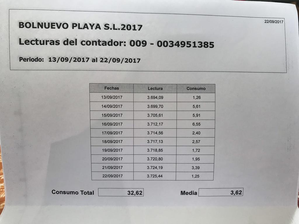

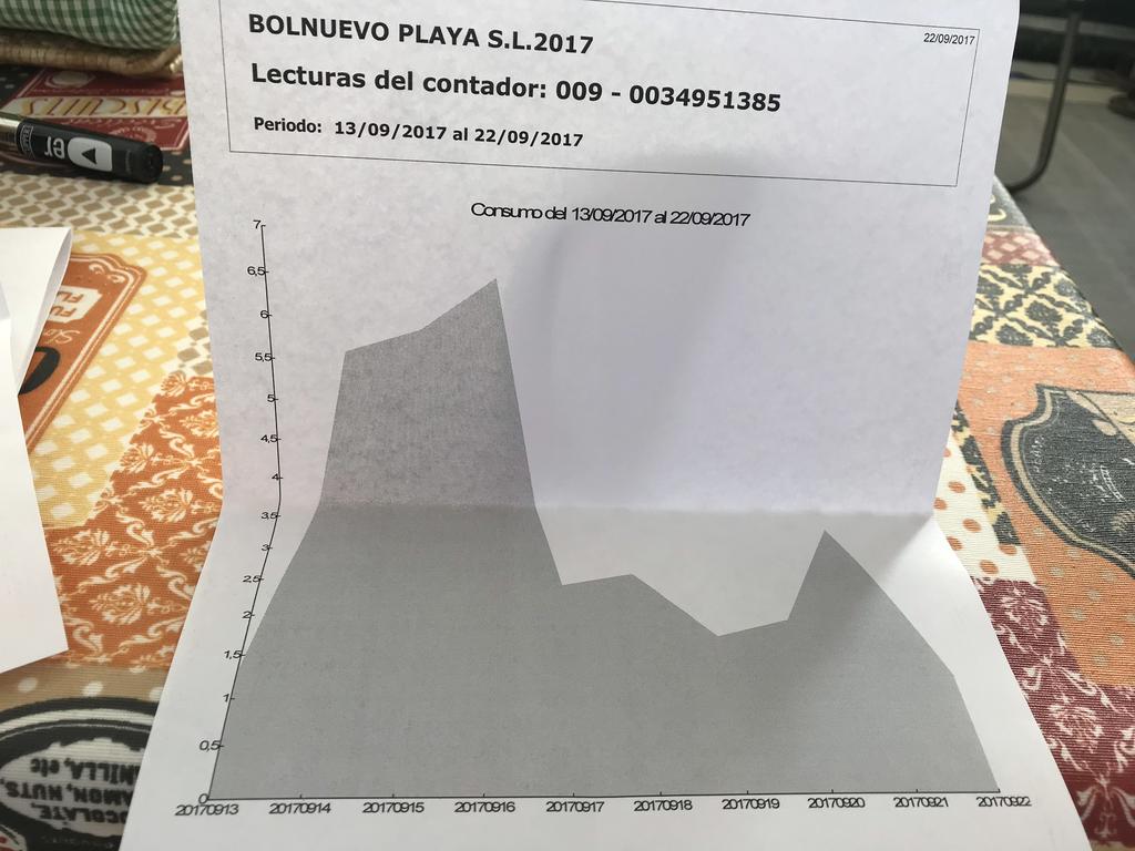

We have spent the last few winters at the campsite mentioned. The free allowance is 7kwh averaged over the period you stay. So if you stayed two days and used 1kwh on the first day and 13 on the second you would not pay any extra for your electricity use. At any time the site will give you a print out of your electricity consumption as per the attached. We have always exceeded our allowance mainly because of the motorhome fridge being power hungry, we could switch to Gas for the fridge but we have a refillable Gas system and the 22kg of Gas we arrive with would not last us the full period of time we stay here and it’s a ball ache to take down the awning, disconnect the plumbing etc and drive off to fill up with Gas.
Unfortunately we do not have access to the meters here so it is a matter of trust when folk are told what their electricity consumption has been. It is also a point of endless discussion (if you can be arsed getting involved) between folk who spend the winter here and rock up with washing machines, fridge freezers and other appliances and claim they never spend a euro extra on their electricity and folk with self contained motorhomes who sometimes pay extra. The extra charge btw is 35cents per kWh over your allowance.

35c/kWh is not that excessive a rate really, but @35c/kWh when over your allowance, you would have to use over 90kWh of electricity in 7 days to get a bill of €15. That seems an awful lot of power to be using in a week in a van?
