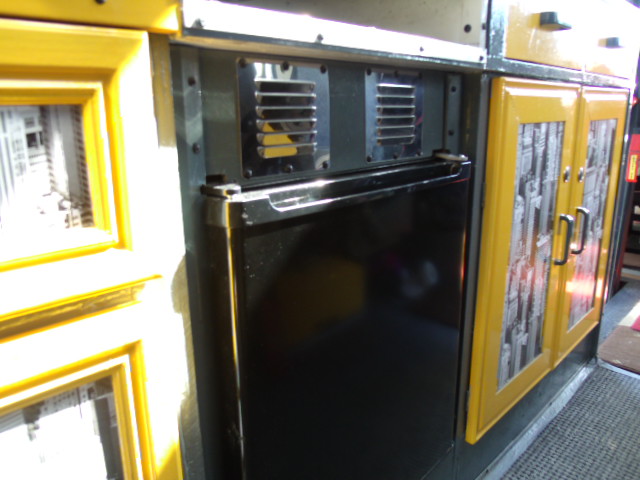

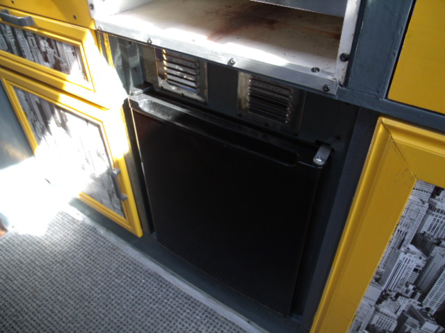

Even though my fridge is a sealed unit I have a airflow under and out the top, also keeps things like space behind fresh.

Mine is completely sealed at the back, tested in the house, no heat coming off anywhere, had me baffled, fitted vents anyway.
