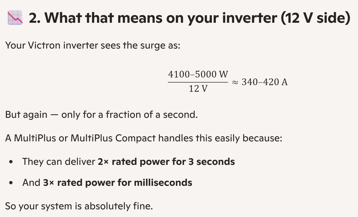

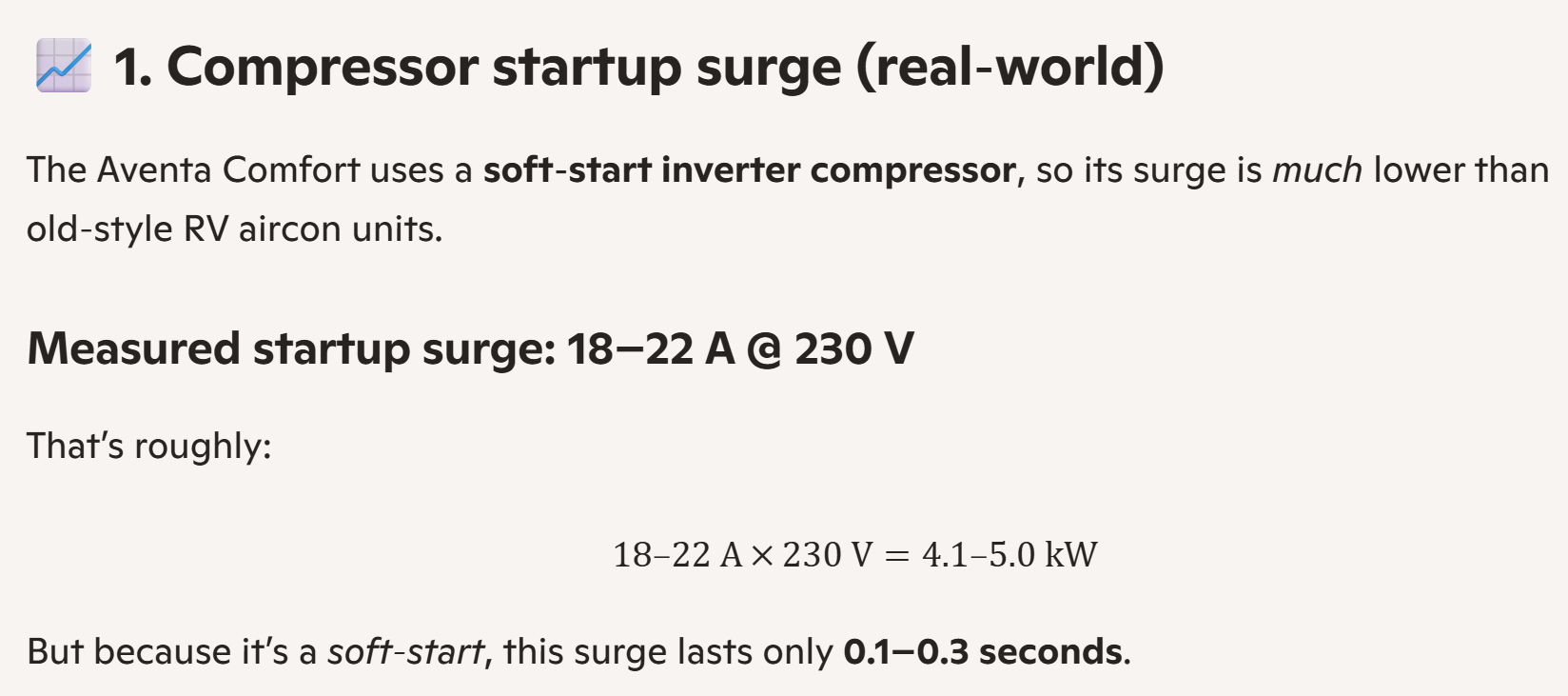

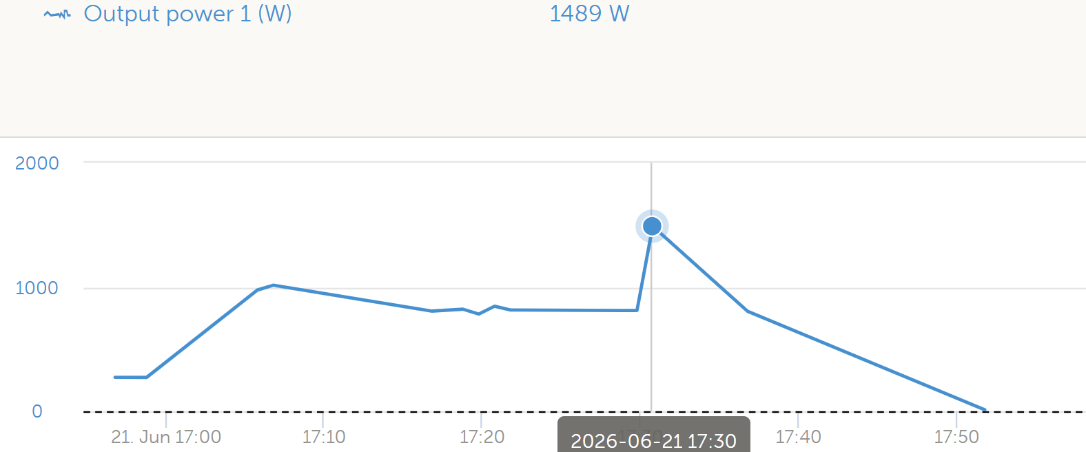

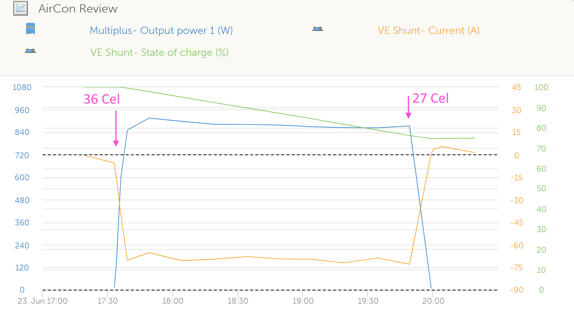

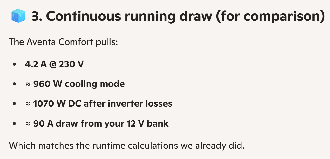

I've no experience of a 12v one, but our roof-mounted Dometic runs fine off the Inverter - pulls around 1200W when on max cooling. It'll sometimes trip our 1600 Multiplus II inverter-charger due to the in-rush current when it starts up, so I generally start the blowers first, then turn it onto cooling.
That’s interesting to know, I just assumed a 240v one was a non-starter and didn’t consider one. My inbuilt inverter is 1800w so that’s a possible. Although 1200w = 100 amps and I assume you’ve a large Lithium bank?

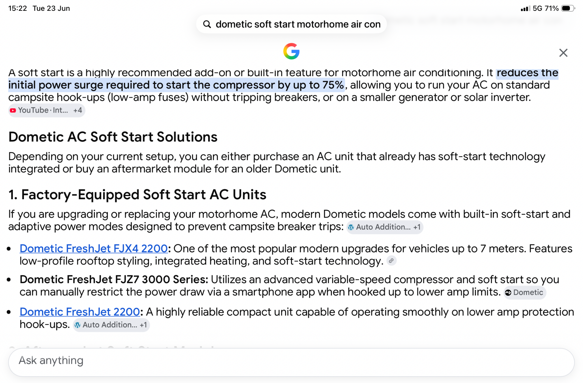

Our concorde had the soft start version in the bedroom , a dometic i believe! This was easier on the inverter/ battery bank we found setting it to a couple of degrees below outside temp kept the bedroom sleepable and as the outside cooled down at night the air con didnt kick in too much
