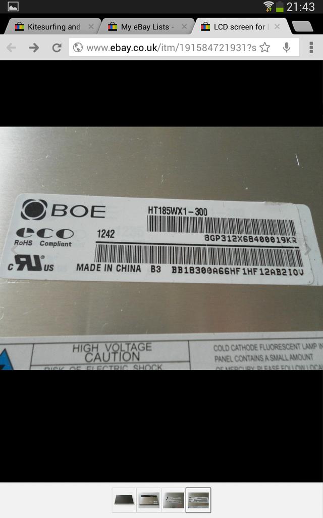

Just replaced my celos 19 inch screen, not new and it's led myself. £15 +10 postage from Latvia 7 days fle bay:king:
Arrived fitted in ten minutes 5 screws and just clips in .

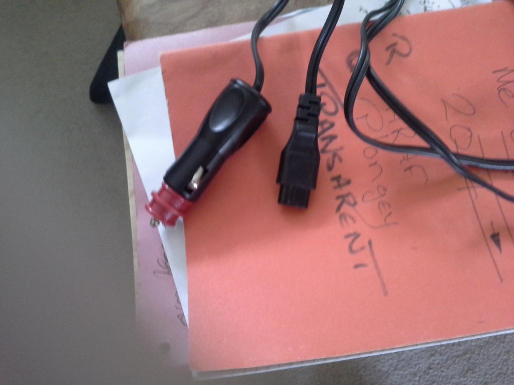

power lead
The one in 1st picture is from a 12v cooler box. it is different to a stereo 240v or vcr power Leads?.

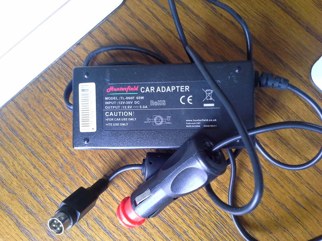

the second picture, this one is for my 35 watt 19 inch television, as you see its rated for double the watts and 5amps
This from amazon 7.99 + postage
