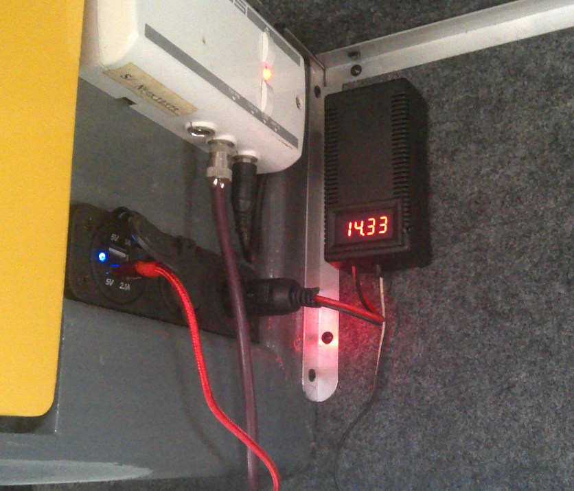

I have one of these voltage bucks as my 12v tv had no sound on load below 12.4v, so input set to 12v and output to 14.3v, i put it in a ventolated plastic box with a volt meter on it, i have seen them on temu with or without the meter but no box, they work very well and no tv drop out.

So you are sorted, i had to use a votage up buck because i used a tv which had a 230v to 12v transformer, when i pluged into van the sound went of below 12.4v, so a buck keeps it at whatever you set it at untill the battery comes down to a preset, mine is 12v or just below, but the output stays at 14.3v.
