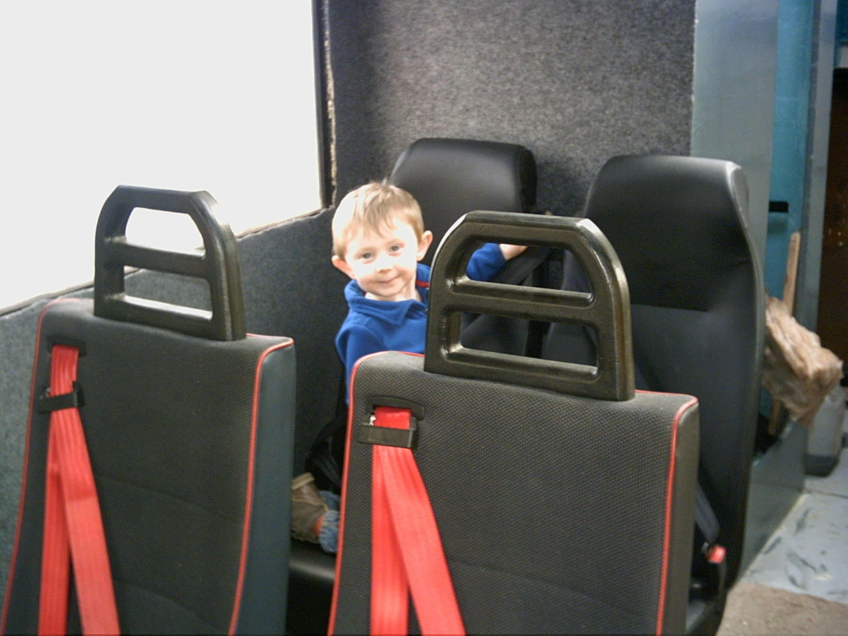

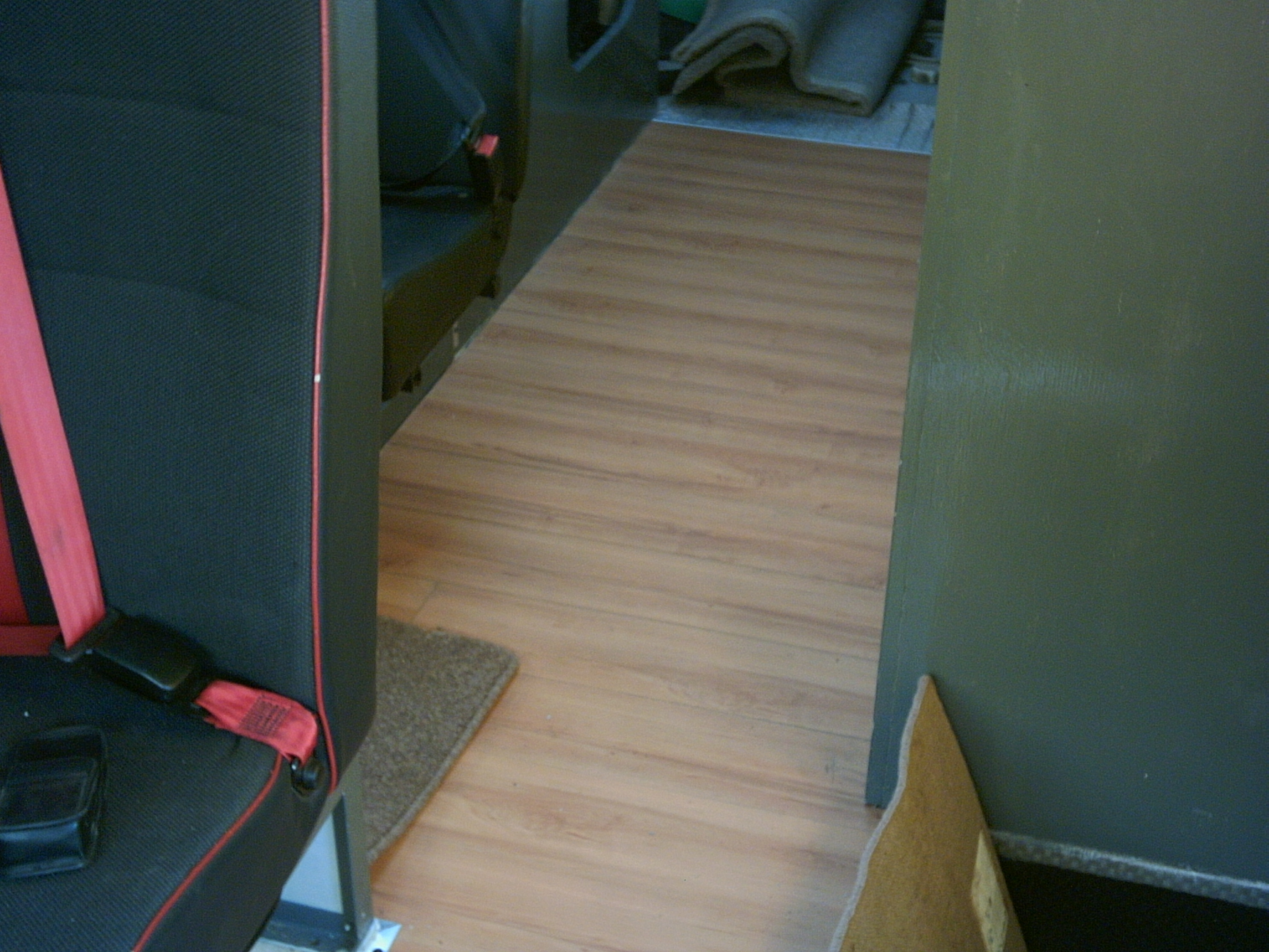

My camper was a lib bus,built 1997 but first reg 2000,failed first time at mot on belts,went home read the regs,if wooden floor then mot cannot test,anything built upto 2006 belts can be tested,after that a under floor plate made to v construction and use regs must be fitted if a steel floor.
Front seats must have full 3 point belts and or a centre seat can have a lap belt if no part of a body can strike the dash/screen or other hard opjects.
Side facing seats are now a no no with insurance co altho wear ok if built in the eightys.
After 2012 all seats for convayance should be marked as such<eu regs> but as no set standard is in place the mot cannot fail a van/bus.
Now i think with us maybe leaving eu some things may change again,its a mine field going through the regs but my bus passed even though reged as a motorcaravan,and with a wood floor,but i made under floor brackets across chassis struts,belts are then built into the taxy seats i fitted.

It should be noted that the MOT regulations and standards are to a minimal quality. Even if something is good enough for an MOT doesn't neccessarily good enough for day to day use.
A good example is Tyres ... got 1.6mm of tread on your tyres and you're golden (y) But how many responsible people look at that level of tread and think "woo hoo. sorted"? Most look at changing at 3mm (which I think is the legal minimum in Germany and other European countries anyway?)
Seat Belts are - IMHO, although I know some others have other opinions - in the same area. Trevskoda didn't have to do anything about seatbelts but top marks for him to making his van safer than the legal minimum for his own and his families safety 👏 👏 👏
