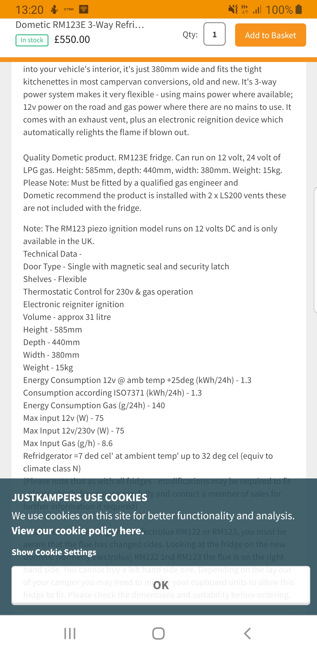

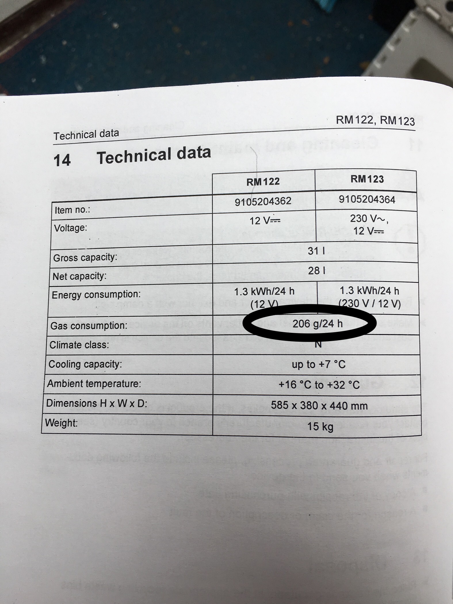

Excuse my ignorance but is this gas usage per hour or 24hours ?

that's nearly half a pound of gas daily in old money. when living in a van , using the fridge doubled the cost of gas , so we stopped using it

I really don't understand this complaining about the excessive gas that 3 ways apparently use. I have had gas fridges for the last 25 years or so and have never thought that their gas use was over the top, indeed the burner flame is minuscule in comparison to the flame of a gas heater. I think that fridges have had bad press mainly because folks over use of the heating and then blame the fridge, or the fridge has been "Serviced" by owners who have cleaned the jet and at the same time made the orifice too large. I remember once being parked up next to a van and sat outside you could here his fridge roaring, when I asked the occupant about it he said "Oh Yeah! Its been doing the since I cleaned the burner" when we took the grill off and the metal wind shield you could see the flame was far too fierce, on further questioning he said he had used an oxy/ acetylene nozzle cleaner to clean the jet. 😲 How he got even the smallest nozzle cleaner file to pass through a fridge jet I don't know. Though I do have to say that some of the older Electrolux fridge jets are a bit Heath Robinson in construction and leave a lot to be desired with regards to finesse and economy. Phil
P.s. Don't forget also the stated gas use per 24hr by the manufacturer is constant burning, but with the thermostat cutting in and out and what setting you have it at will dramatically reduce this amount of gas used.
