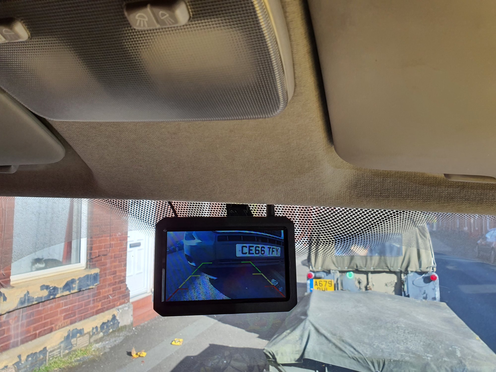

That sorted decided to crack on and fit the wireless reversing camera I'd bought a couple of weeks back....
Display stuck to windscreen and plugged into cigar lighter socket...
Mounted camera and wired it in.... No reversing lights fab,
Fuse checked and OK.... Reversing light switch must be up the Duff.
There will be a special place reserved for whoever at fiat decided to mount it in a position that requires a scrawny orangutan with unusually long fingers to get at....
Air filter and hoses out, clutch slave cylinder and mounting bracket removed before its possible to get at...
Anyway all done now and working ;-)
