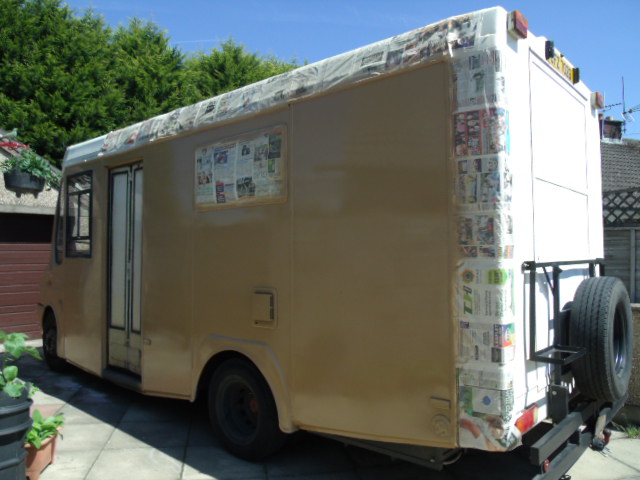

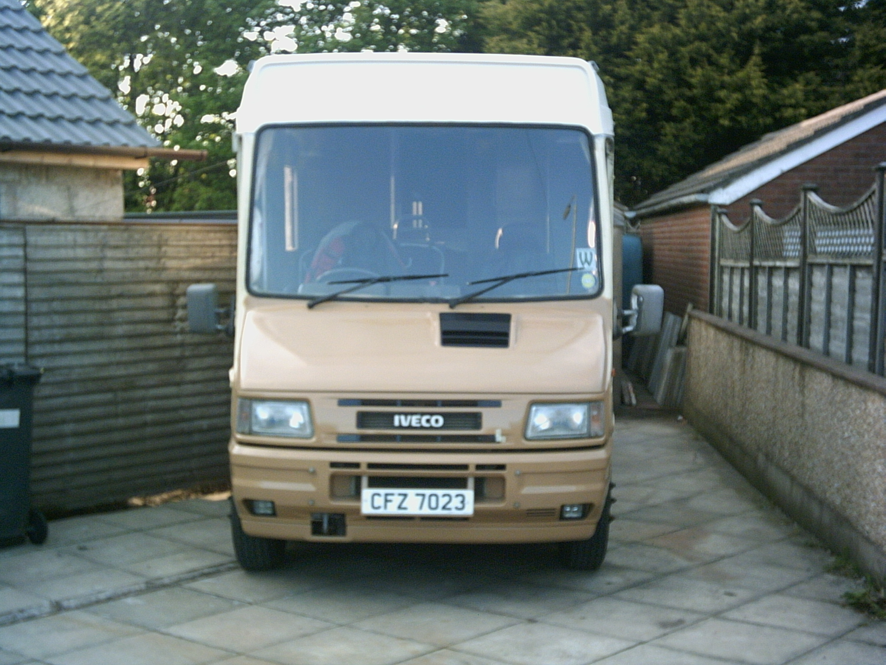

My iveco lump was also to low a diff as a ex library bus it was only able to do 45mph at the middle of the green rev band,so i changed that,it can now cruse at 55mph at same revs and return 30mpg.
Buses are usless as the single glass windows run water like a river,best to go for lib busses as you can cut out windows where you want and fit seitz units,the ivecos are all 12v where as the mercs im told are 24v where a voltage drop unit will be required for led lights etc,i have seen a few merc vans here and they are good strong units if coach built rather than the rust bucket vans.

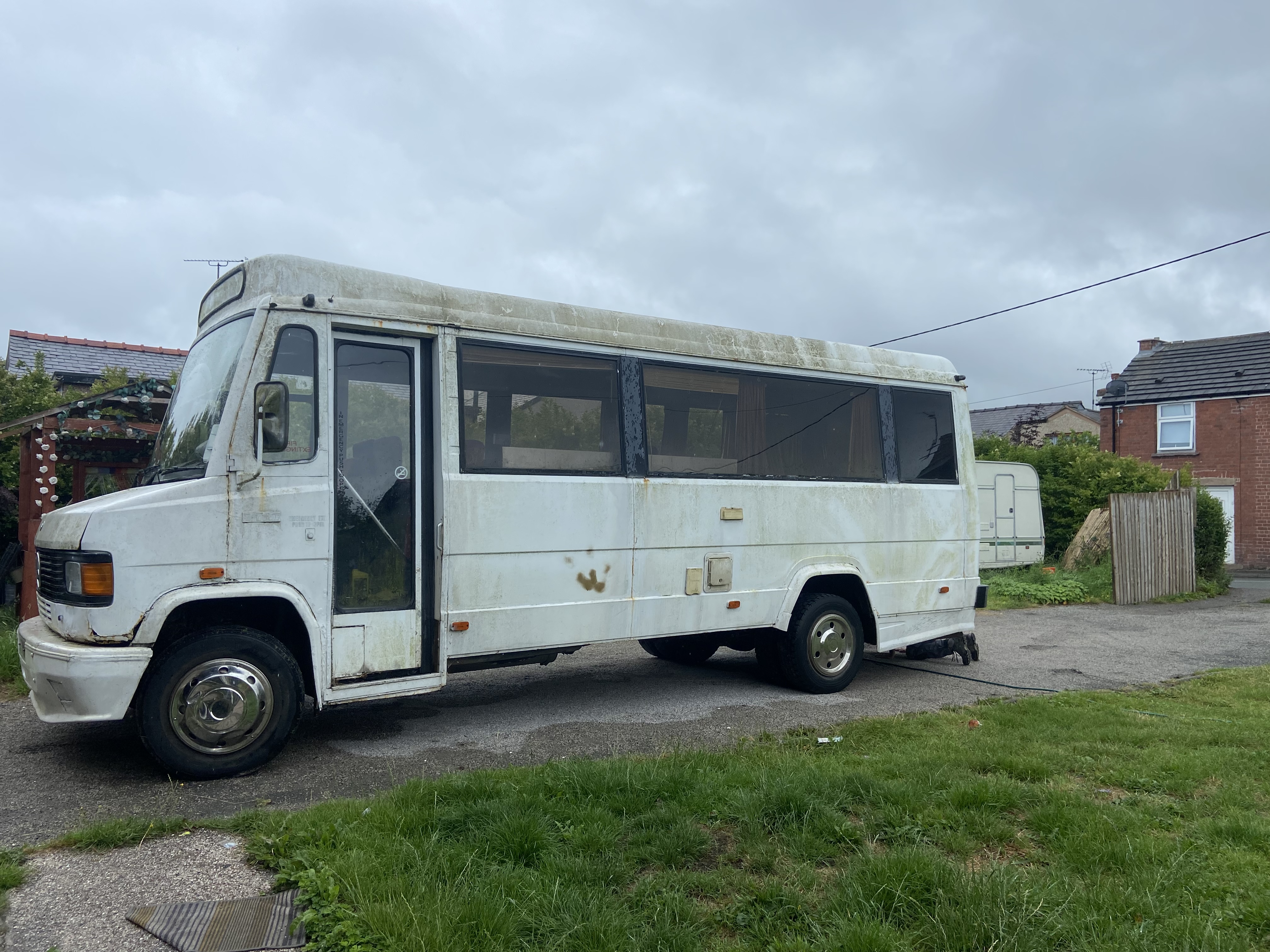

Hi everyone, thanks so much for this post, im a newbie that just purchased a Vario 711D Bus to convert, during lockdown, we converted a Vivarro, i know this is a much much bigger project and we appreciate all help we can get. If you have one please please share with us your knowledge.
After a eventful trip to bring her home.
She is here
She is here
Hi, these older T1/2 are fantastic mechanically, the engines are what Mercedes built their million mile reputation on! The manual gearbox is also bulletproof. Luckily they are built on a super strong ladder chassis which lasts forever!
However the body work is shocking the tin work just rots in front of your eyes.
the worst bits ( long list ) are all along the bottom edge, all the seams, and as you have windows all around these too…having said that these areas are a fairly easy to repair if you can weld….. then even worse the under the windscreen and down inside the wings, theses spots are more difficult to repair.
my advice would be get the bodywork solid before you start on the conversion.
You’ve chosen a great vehicle & they will give you many years of reliable service once you sort out the body work.
good luck with your build I’ll be interested in your progress.
As mentioned, strip all the interior panels out first. Deal with the rot before spending any money on it. Btw, it’s not a Vario. Oh, don’t forget to remove the windscreen. It will be rotten where the glass fibre joins the steel.
