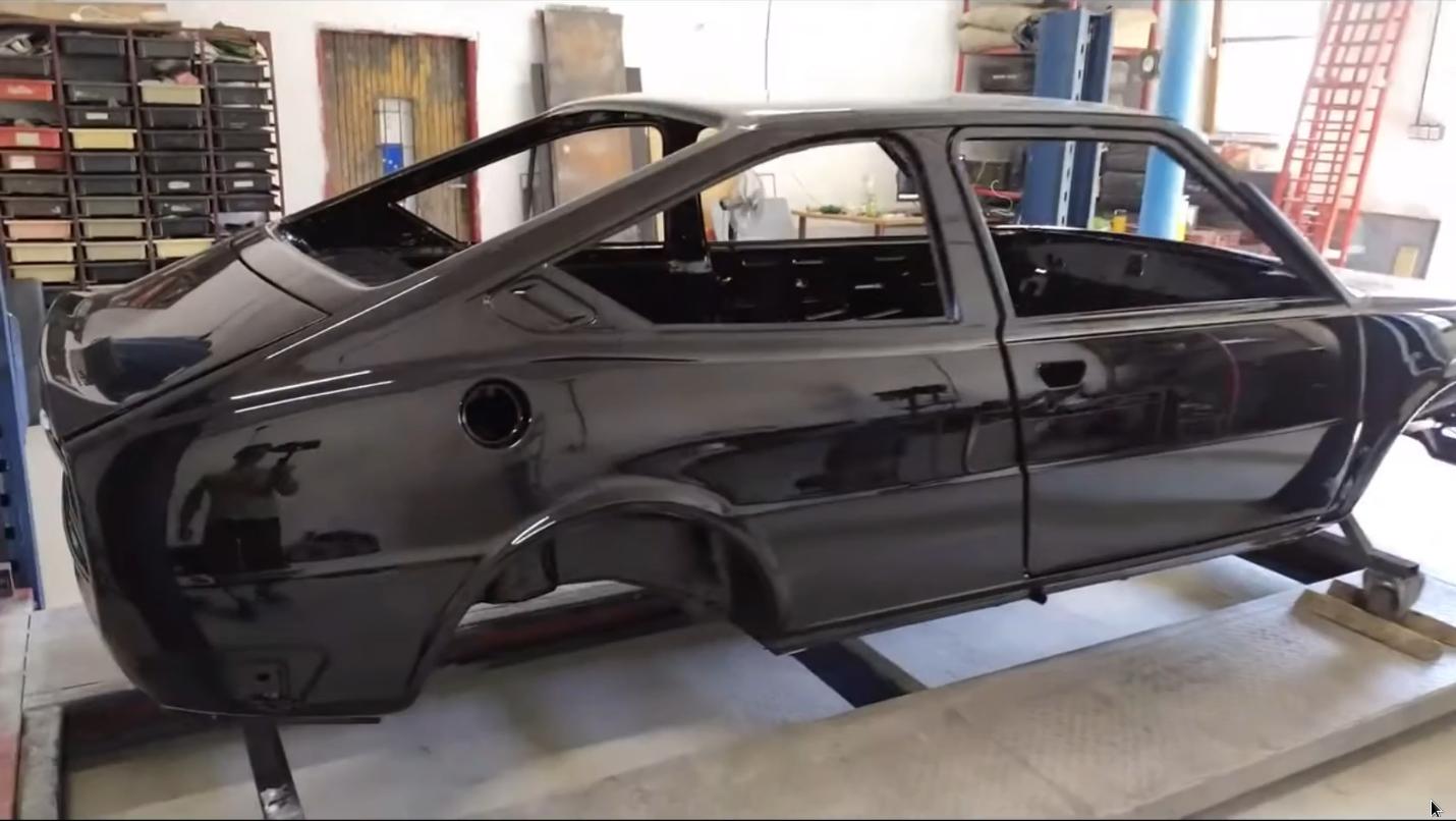

Didn't know you had a porsche Trev.
Better than.
