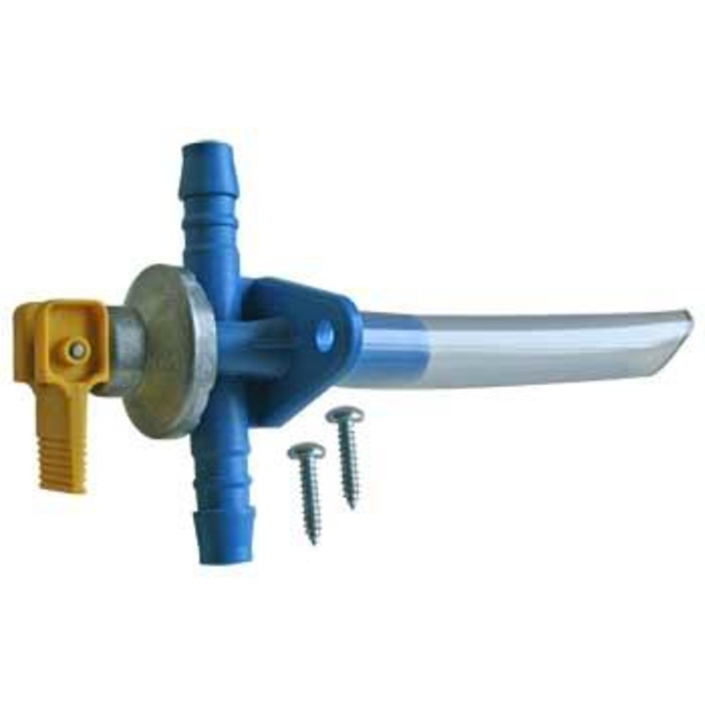

Hi! We have just bought our first Motorhome-a 2011 Elddis Autoquest 130. We are complete novices and we are trying to get water to pump from the aquaroll into the taps but nothing is coming through. It appears to be coming out of an overflow pipe underneath the Motorhome. We don’t have a manual and the one I’ve found on the internet does not show where anything is on the Motorhome. Any Idiots guides Greatly appreciated!
Look in water tank for drain plug/valve and check boiler dump red plunger or 3 way valve

Sounds like the drain valve is open to me,no other reason water would pour through unless a pipe off albeit you would expect water everywhere
At the side of the hot water tank is normally the pipes and a little lever most colour coded yellow , if it’s vertical it is in drain position ,, it should be laying flat parallel with the piping,,,,this is the normal newbie mistake rather than a troublesome system
Probably it was drained for winter/storage and when sold a proper hand over not able to be done due to social distance rules. But it does sound like drain valve open
Look inside the van above where it’s coming out, probably an electrical solenoid valve with a button to reset it or just drain valves left open. If it comes out faster when the pump is working that’s what it is.
