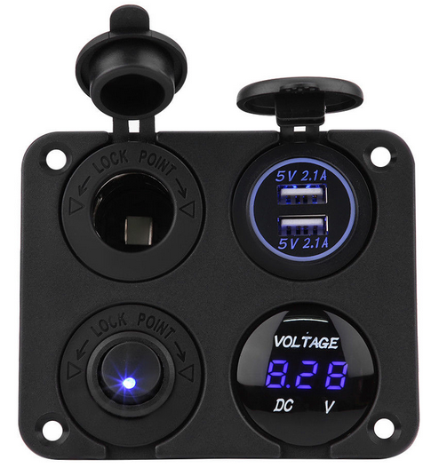

Good solar mppt regulator to charge engine and les batteries,deck gland to bring cables from panel in,mains trip/fuse box and some 12/5v sockets and a battery voltage monitors,and a 12v led fuse block,some led lights and pos some switches
solar duel a.pngdeck g a.png4 way panel.pngvoltage meters.pngfuse block.pngled fuse block.pngstrip lights.jpg
