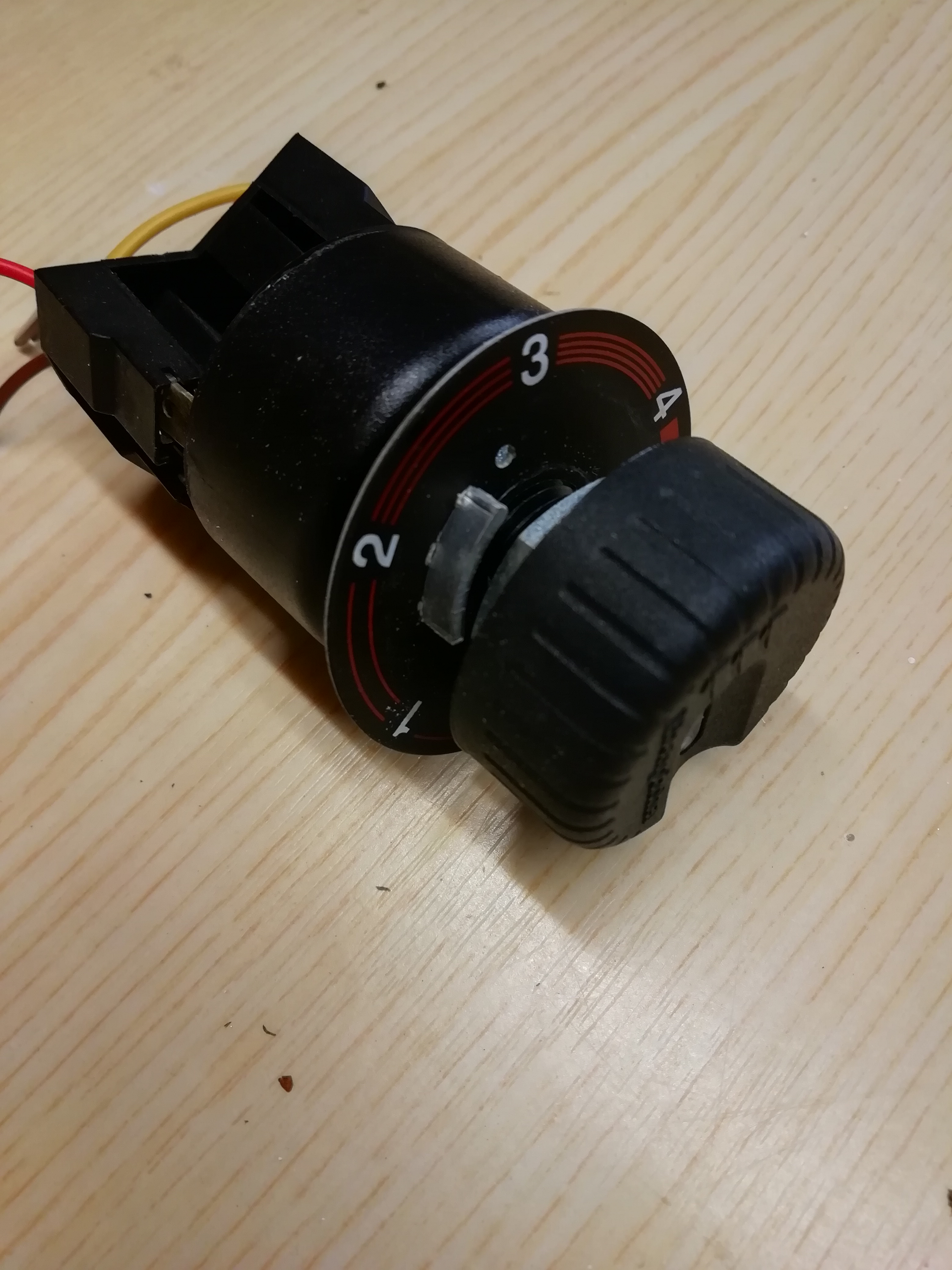

I think I now the one you mean Gregg, Murky had one originally. I'm told the newer controllers will operate it. As the heater had been taken from mine, so I put a newer self contained eberspacher in it. I'm guessing yours has a separate electronics box.
@Greggbear67, Here's a pic of the rotary eber control I have just removed - sounds as though it could be the same as yours.

Think that looks like one of the switches. No positions as such, just rotates. Then next to that is another rotary switch with 4 click positions.
The other switch might control something else because I only have one control for the eber.
Is that not the rheostat controller shown on the link Greg? It says the switch connects the red and yellow together to turn on and the diagram shows red, yellow and brown wires that I can see in your pic
Sorry Neil, my pic doesn't show all the cables but there were 5 connected. The blue/white and brown were not used.
