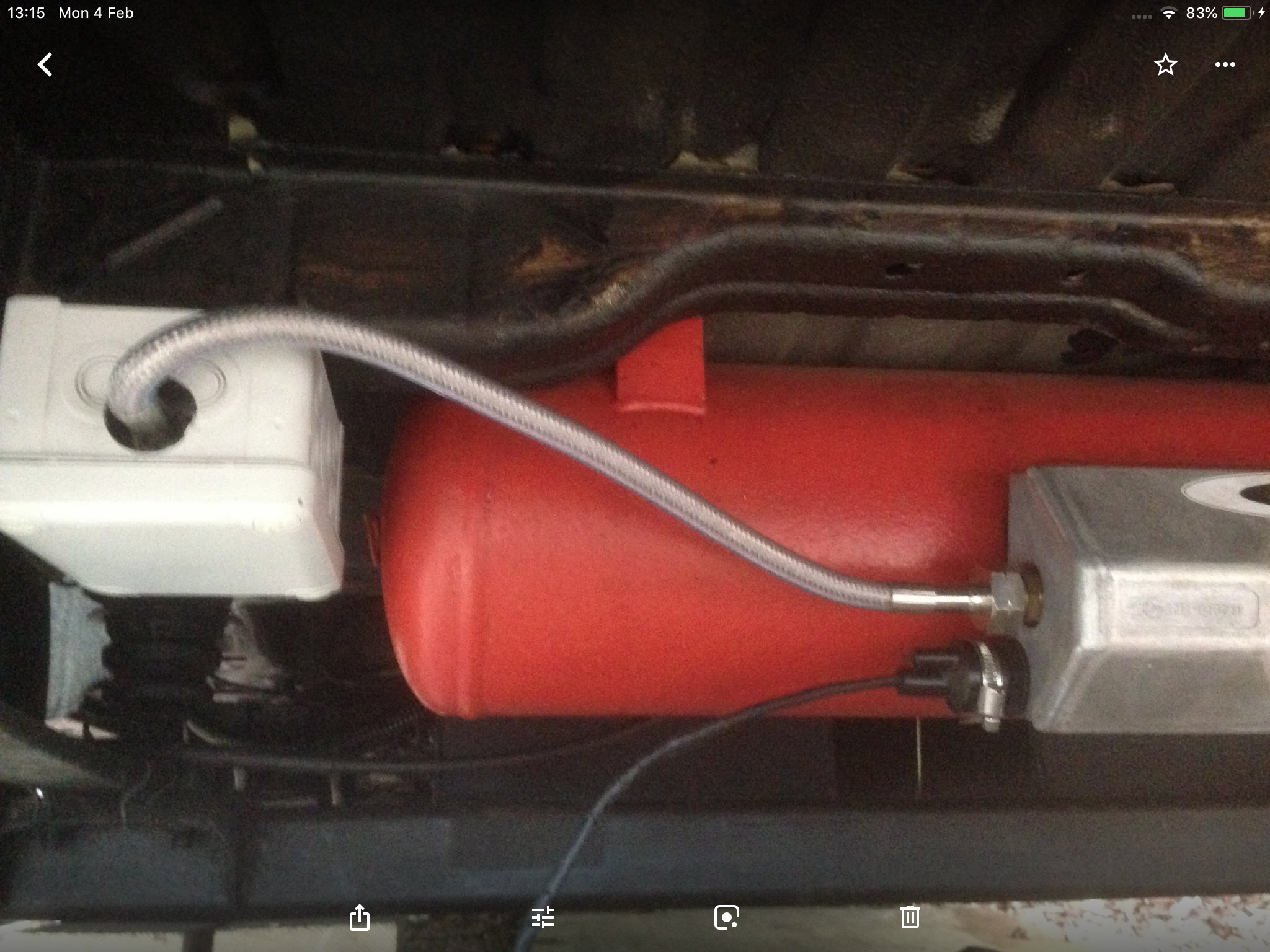

Here’s a few images of ours we stone guarded it before installation
As Squiffy says it’s straight forward just take your time! Though if in doubt get someone that’s confident with gas 😀

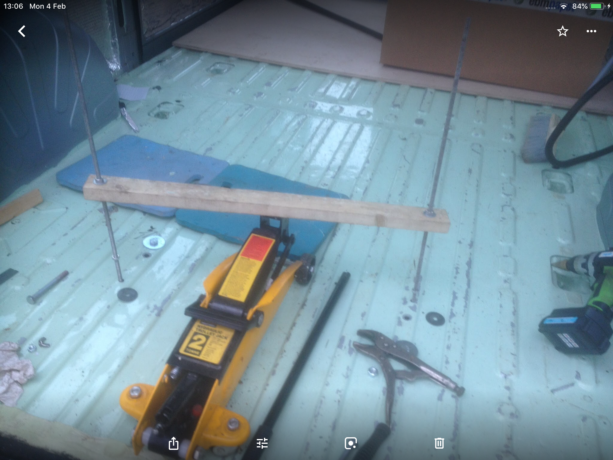

Might be an interesting job for me and mechanical son to do, don't have a lift though but quite friendly with Mechanic so I might be able to use his.
I had retired and sold the garage when I built this one, I managed on the ground by running the front wheels up on ramps and jacking up the rear onto axle stands, it was tight and uncomfortable at times but was fairly easy, I also fitted the waste and fresh water tanks at the same time. Phil.

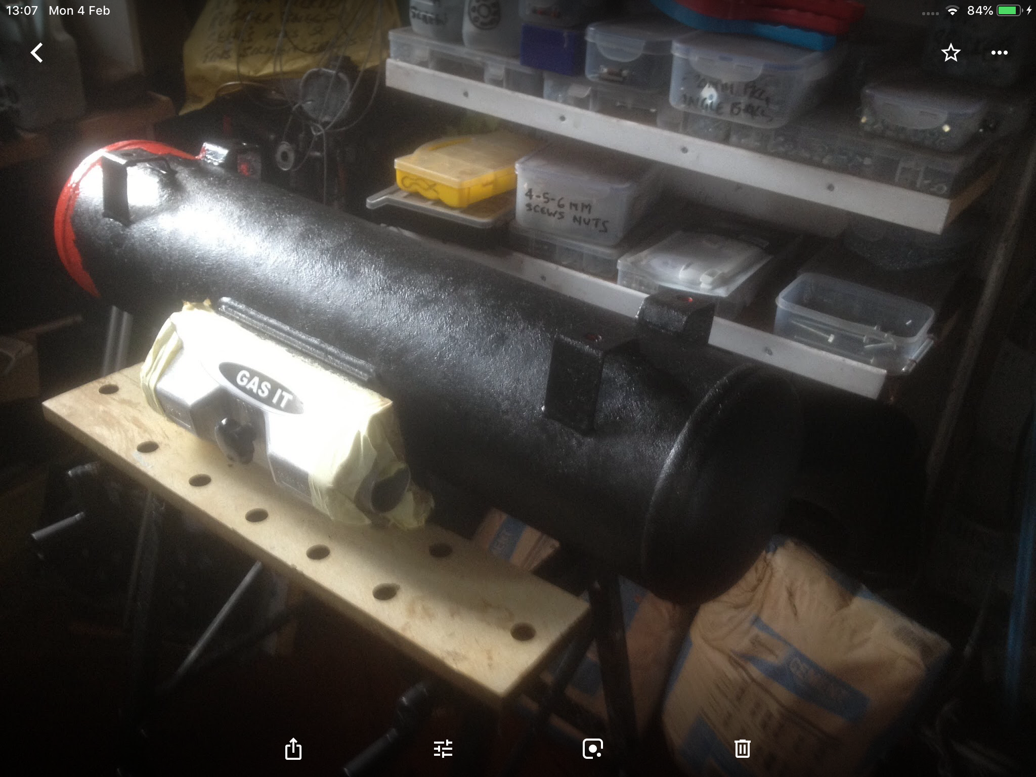

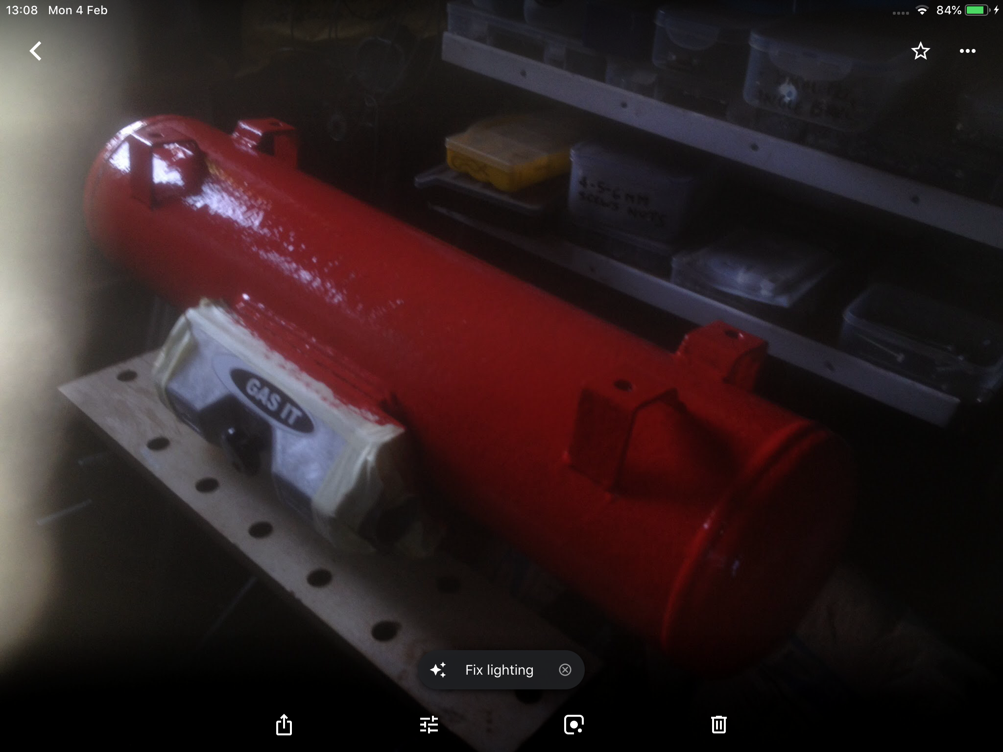

No use stone guard unless its shotblased and painted proper first as there red coating will be on blue scale steel and will let go.
Drives me mad that so many co make things well only to do a crap paint job on there product.
