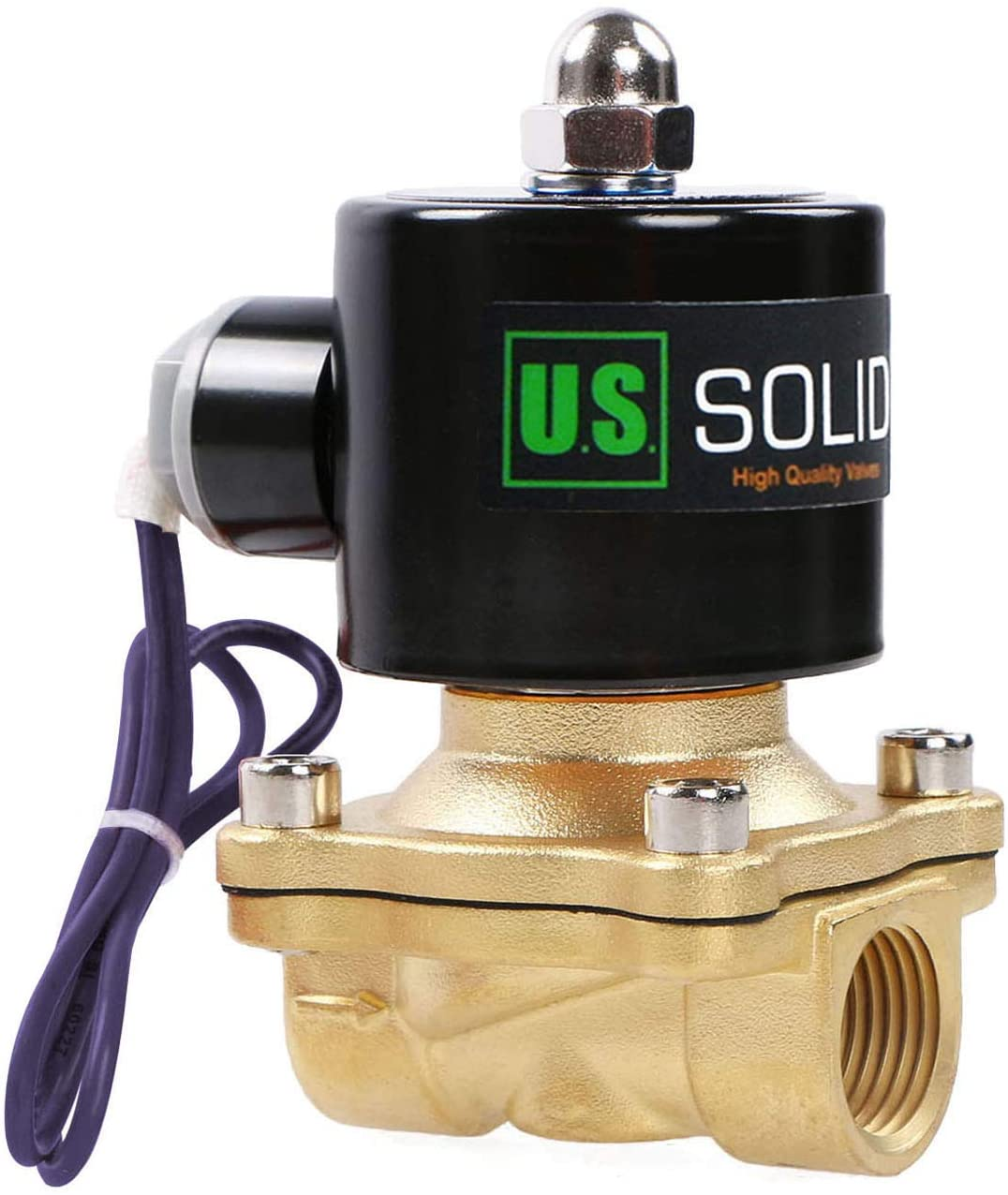

What about fitting a remotely controlled via 12V supply to turn the valve on and off? anyone done this?
I am thinking about this kind of thing .... https://amzn.to/3crgSdS
Now I don't know if that one linked to is appropriate (need to consider thread size, reversed threads for gas, etc, etc.) but linking to this as an example to illustrate the principle for the idea.
Maybe some top-end motorhomes already have this kind of thing?
I think some do have a system that is designed to be allowed to to be open when travelling, but I am thinking more of a setup where you shut down when travelling - and maybe this could be controlled by the Ignition or engine running signal, same as the electric step for example?
Not designed for continuous operation whilst energised which is the state it would be in for gas to flow. As you may need it on for days on end when on a site then unfortunately not suitable which is a pity as it seemed a good idea.
