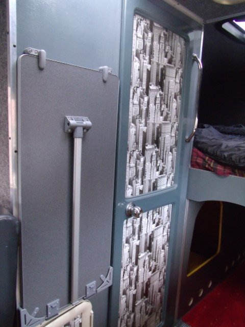

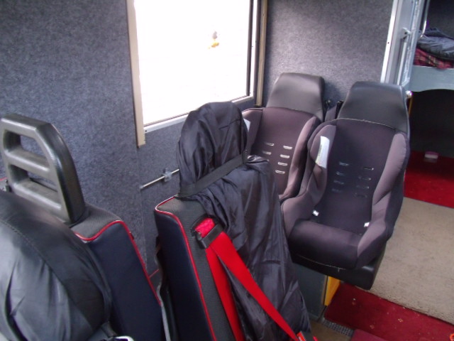

Same here and i detest eating of ones lap.
You can see the wall clip between seats and the out of way wall storage.

No, yours is different Trev. Your table IS fixed to the van if being used and does comply. As I understand it Phils is purely stored in a fixture in the van and when (if) in use is freestanding which does in fact not technically comply with the dvla (or whatever it is now called) requirements. Sorry Phil!!! (Hard hat on and running for cover). Geoff.

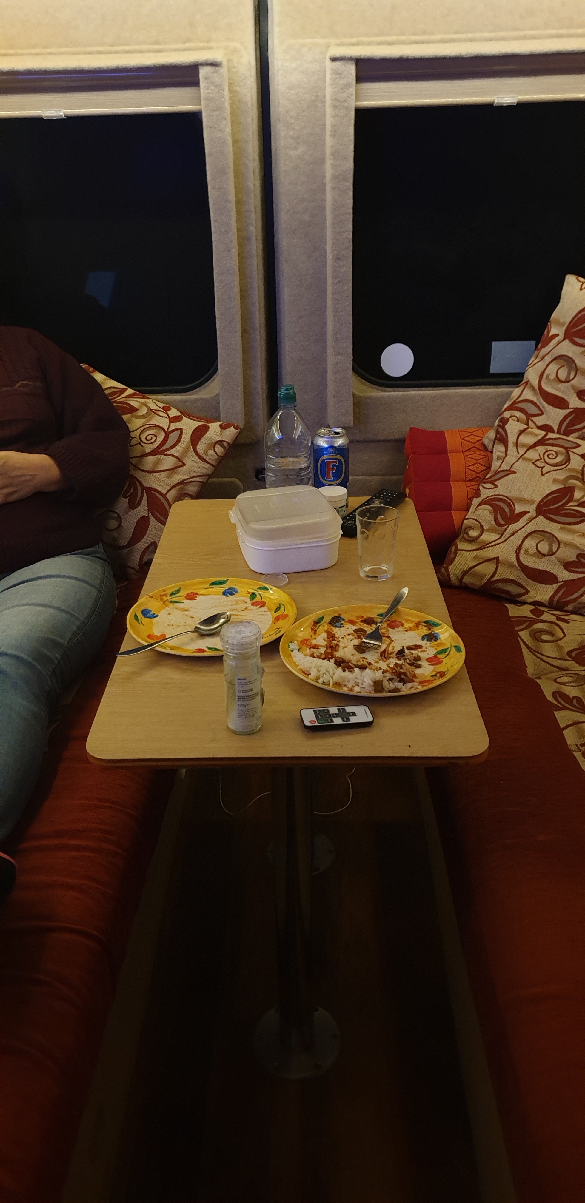

Enough said just finished our tea, chicken curry at Dare valley country park. 👍
Phil (sqiffy), I was referring to the other Phil - of Renault master fame as he had commented about his table. I hope that you enjoyed your tea. Geoff.
I know that Geoff 😄 I was just making a statement as to the fact we use a table, and I have to say that although it's easily dismantled it stays up permanently and acts as a book shelf, remote stand, card table, dining table and many other uses. 👍Phil
