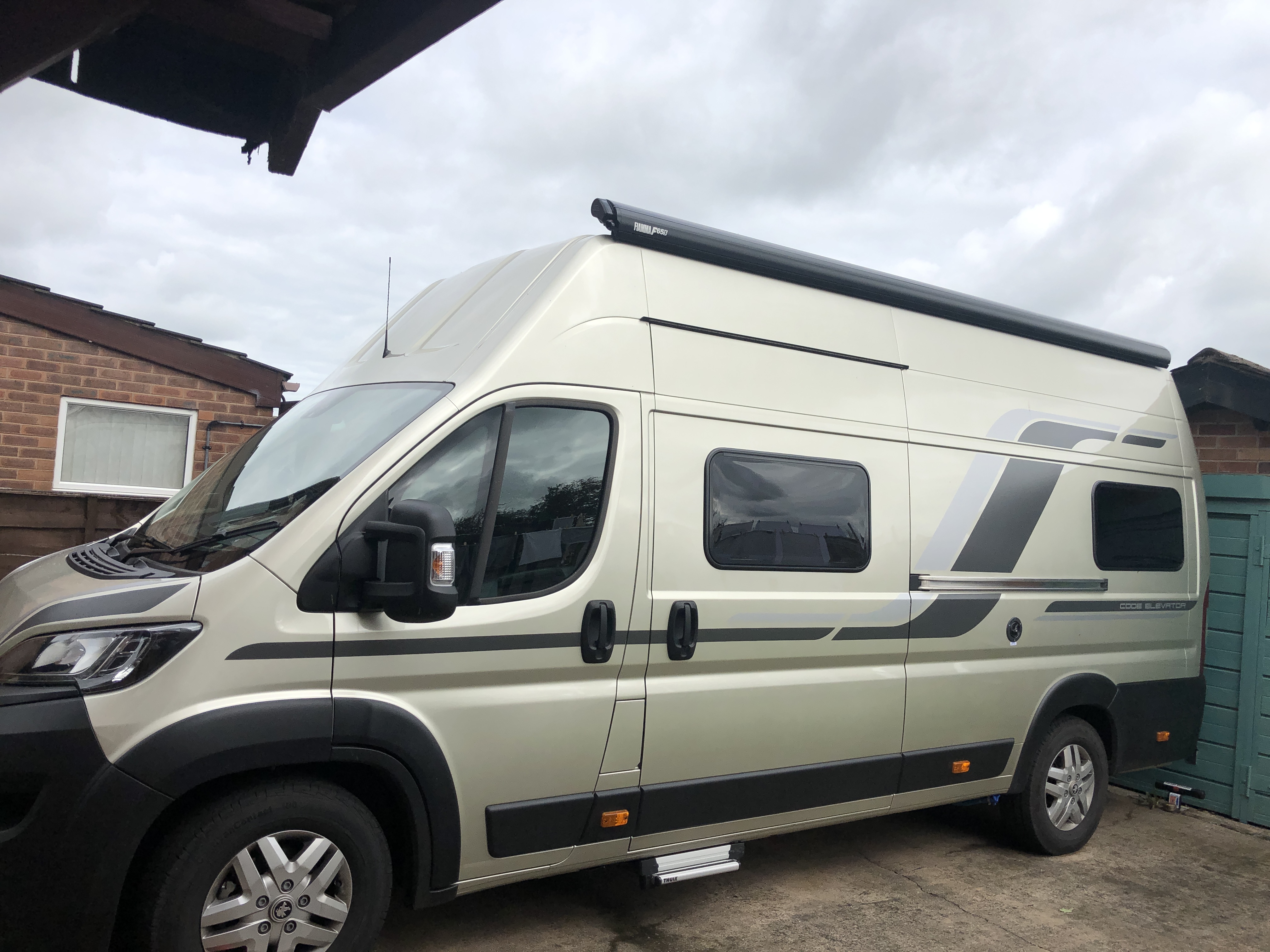

We converted our Mercedes transporter as per DVLA standards (literally I was obsessive) and sent all the pics in just over a month a go requesting motorhome re-classification. Since then, I have noticed on the website that it says this whole totally open-for-interpretation "must look like a motor home from the outside"....and just got the rejection letter today. When I called to ask WHEN this new stipulation about the external appearance was added (I am almost certain it was not there before, but alas do not have screen shots), and WHAT an exterior is meant to look like they told me to google image search. This literally comes up with the same make and type of car as the one I am talking about, as well as such a range of others that are all self-converted like ours. Has anyone made any progress fighting the stricter enforcement? We wasted a ton of time and money focusing on their specs so we could cut our insurance costs in half...all for nothing now :/ (though the van is pretty, at least :)

Think my pictures are above in this thread. Mine looks like a pro conversion from inside but outside didn’t have any stickers on it. I got a rejection letter same as yours . I had the local sign company copy (ish!) some graphics off a ‘pro’ converter and hey presto second try I have a ‘motor caravan’. I did make sure that all photos sent included shots with all the windows and roof vents open and included the toilet hatch , hookup etc.

Im afraid your van is ANOTHER LEVEL of epic compared to ours (nice job on it btw). As ours is a lot smaller (we are students lol), Im not sure your tactics would work. That said, maybe its just a sign that we have to figure out how to earn more money to afford a 'real' van...
