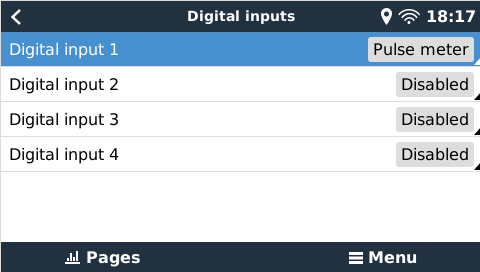

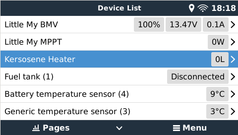

I did this with my Chinese Heater, linking it to the Victron Setup I had installed.
Using a Victron Venus GX (so running the standard Venus OS), I setup one of the IO ports to work as a pulse meter
I called that Input "Kerosene Heater" (I ran it on Kerosene, not Diesel ;) )

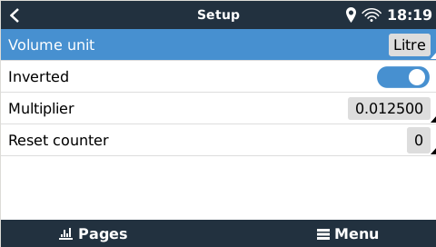

You say it delivers 0.02ml per pulse. I found it - or at least mine - was different. From memory, after I did test, on the Victron setup, I set mine to 0.012500 per pulse, which equated to 0.0125ml/pulse ( the choice of volume was a bit limited)
(I came up with the value after setting the pump up to fill a container and measured the volume after a certain number of pulses and did the maths).
On the GX, I used an Iso-isolator to deal with the voltage difference (GX wanted 3.3V, Pump is a 12V unit).
Not using it now as changed vehicles and moved kit and this was all over 6 months ago so Eons ago for my memory.
Also, the new Cerbo GX (In case you were interested in the Victron route) does not apparently support a Pulse Meter. I have not yet checked if that is correct, but if it is, you would need the GX. The RPi with an IO board would likely work if you found the right input - While I've installed RPi's with the Victron OS, I've never added any IO so don't know on that score. Another Forum Member has done that kind of thing though.

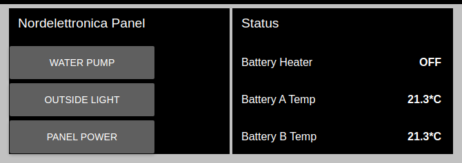

I use an RPi running the Venus ported code.
From memory: To this I added an MCP3208 ADC which gives tank levels etc. and set its Vref to 1.8 volts. Arduino outputs 0 to 5v for PWM (on an UNO) so simple resistor divider to loose 3.8v, therefore 1.2v for full tank, 0v for empty.
The Venus - Cerbo large image for Node-Red + SignalK is worth looking at but I never got the ADC to work with the large image.
My advice would be run the Large Image on a later Venus or Cerbo or RPi, Node-reds Dashboard can be accessed via the Victron Portal. Use Wemos D1 Mini's to count pump pulses, sense lights, water pump, temperature etc, these communicate with RPi. You can then see your tank levels remotely, turn on lights, etc, etc through the Victron Portal. Here you can see Node_Red's dashboard in a browser, to the left are 3 buttons to select/de-select Water Pump, Outside Light and Panel Power. Unfortunately you can't see the state indicators in this image. Another D1 can measure battery temperature and turn on heaters should they drop below x*C. If you had a diesel heater you could get to RPi to send an email when the van dropped below a temperature and you could remotely turn the heater on. I've not looked at a way to turn our Truma on yet, I'm not paying for iNet!
