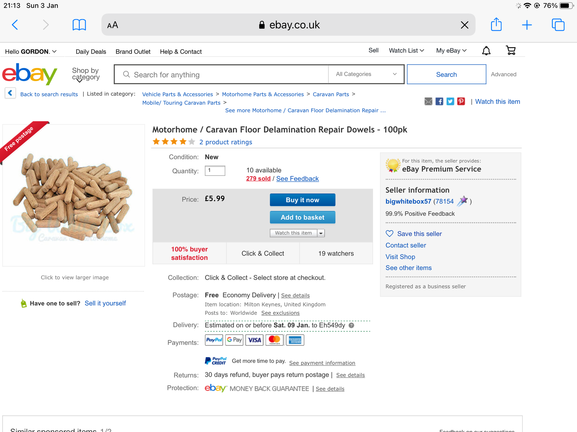

i know you drill the floor and inflect resin then the holes are plugged with dowls

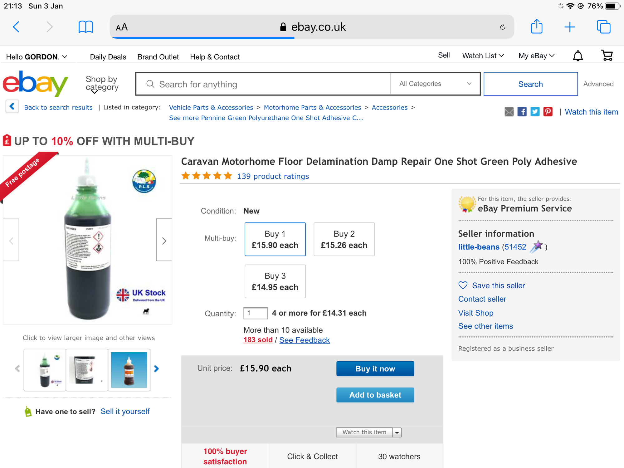

you can buy the kits and save a fortune on dealer prices of repair DBA05481-8B5A-4BD9-BD84-35C1247438BA.png5A10CADE-BB0D-4896-B720-18DF6374A813.png

We had an RV with springy floor in front of the cooker and outside the shower. I suspected damp, but there was none, the ply floor had just delaminated through wear. I took up the vinyl floor and drilled lots of 10mm holes, then injected the special green resin. Plugged the holes with dowels and waited till the morning. The floor was rock solid again. Easy enough to do if you don’t have any damp.

So, if you are doing it yourself and are 100% sure the floor is dry, you need this ( below) a drill and matching dowels, a hammer and cloths.
