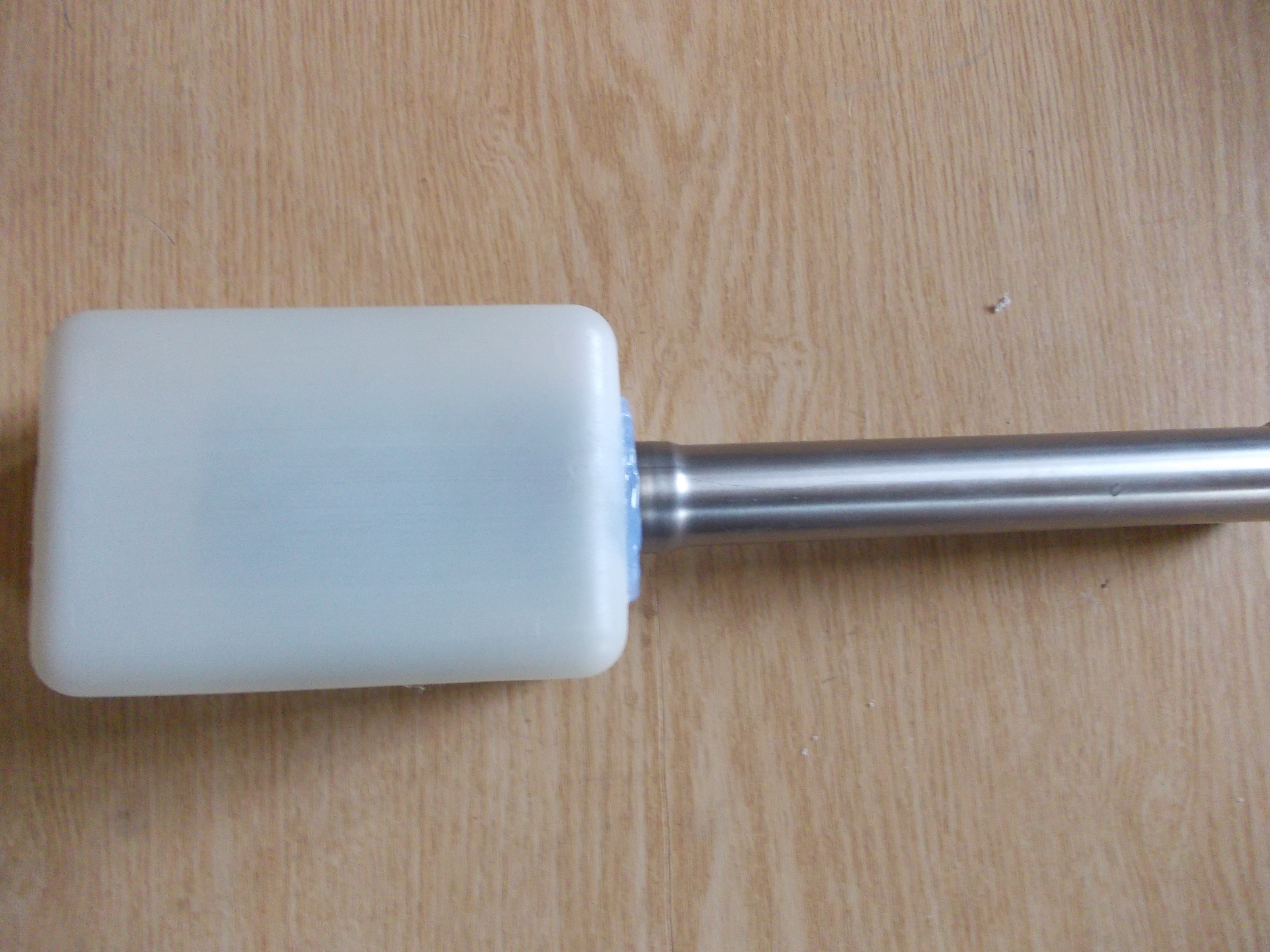

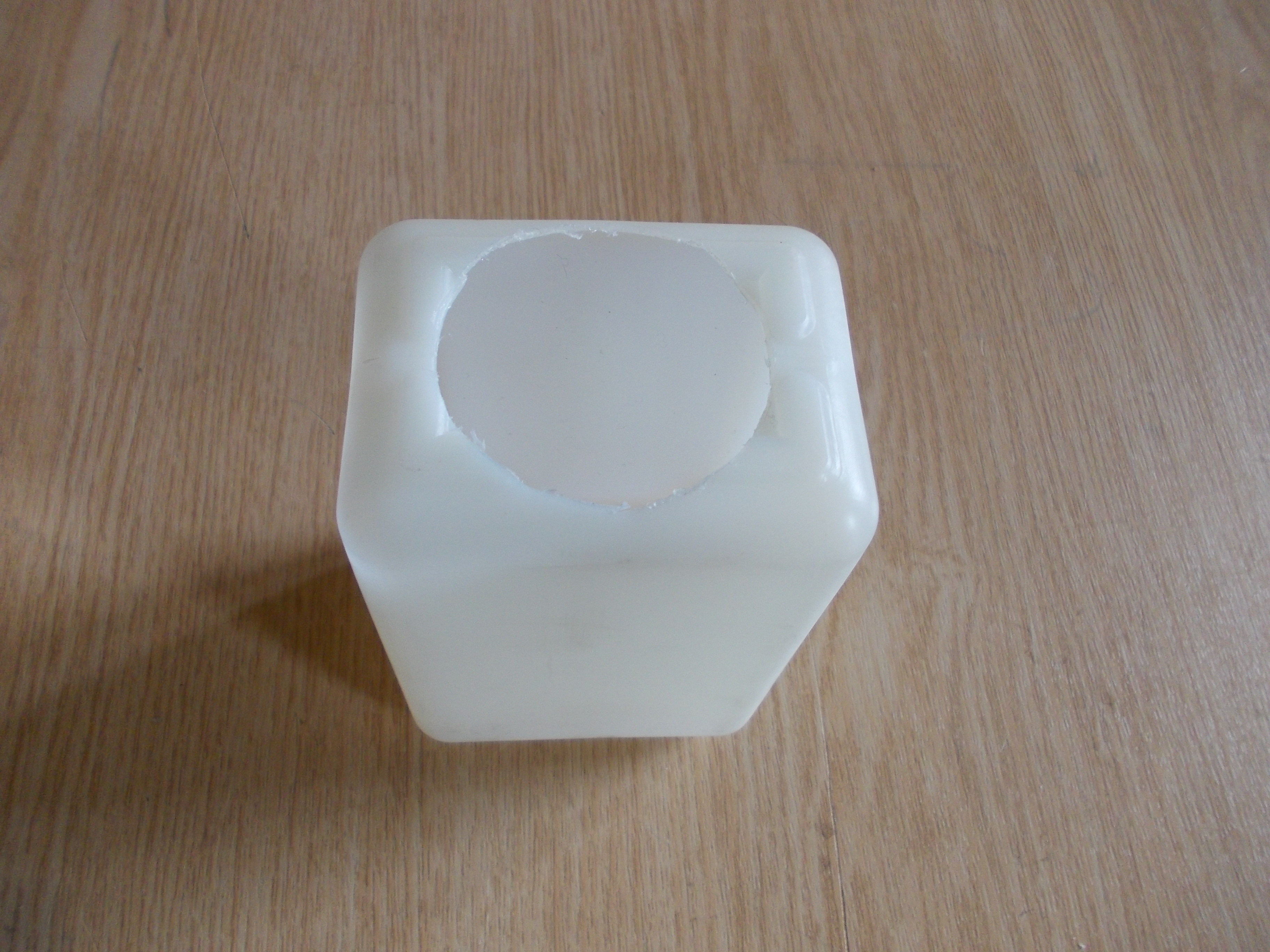

Hi...I removed the inner clear plastic flap thingy from the lid and drilled it out to suit a metal electrical gland into which I inserted a piece of the supplied rubber tube, then on the inner side a piece of the supplied fuel pipe cut to just reach the bottom of the tank, and outside the filter then a short piece of the tube then the pipe to the tick tick pump. I did drill a tiny vent hole outside the diameter of the new gland fitting.

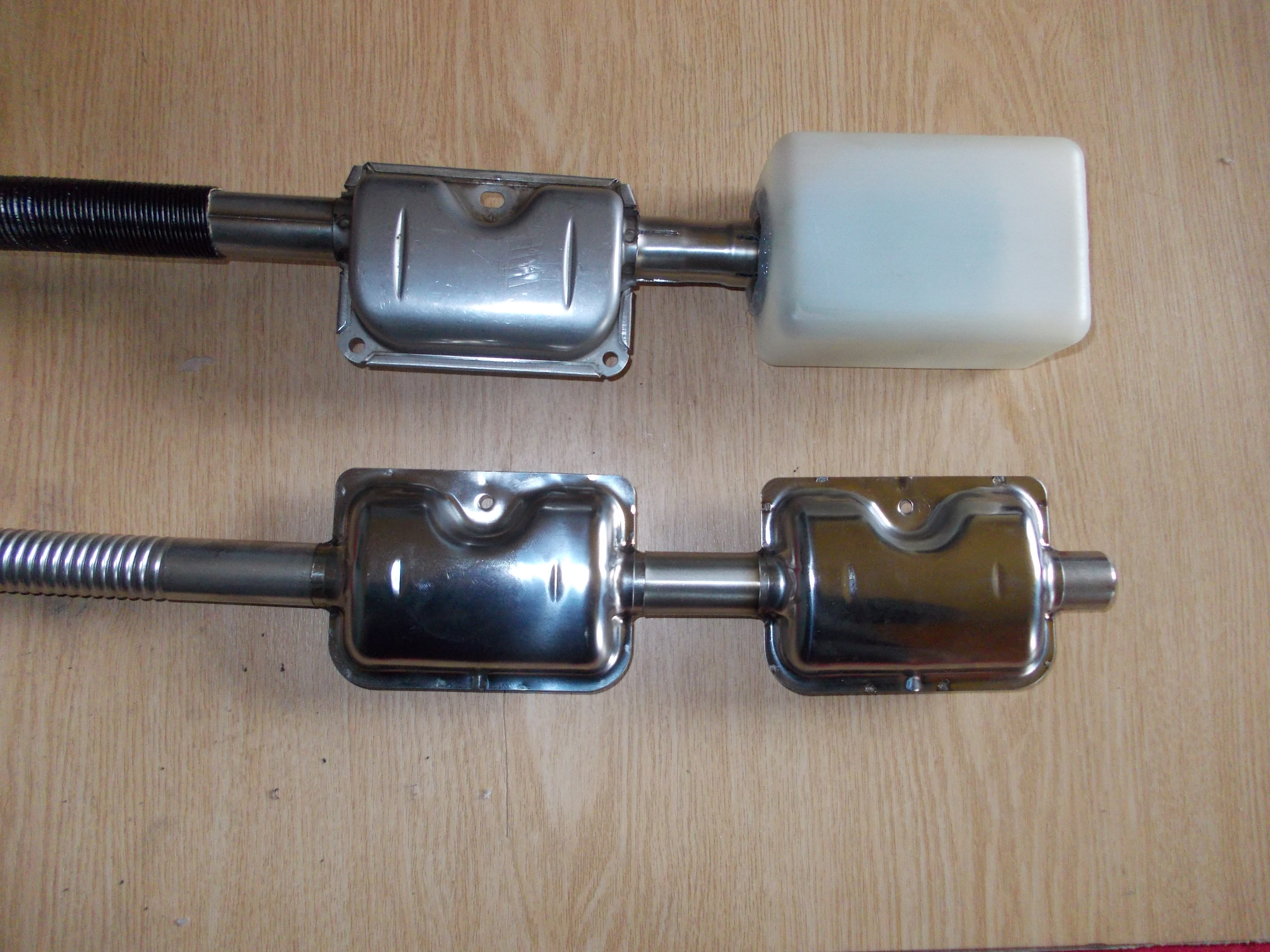

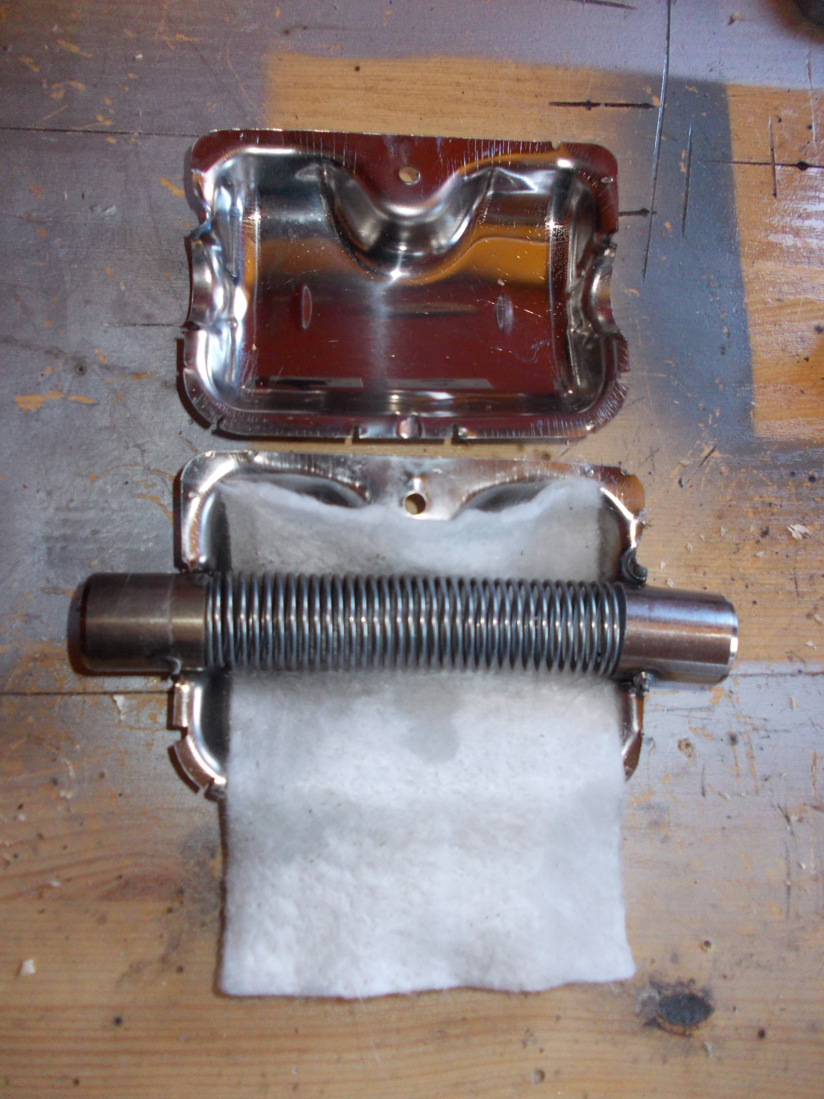

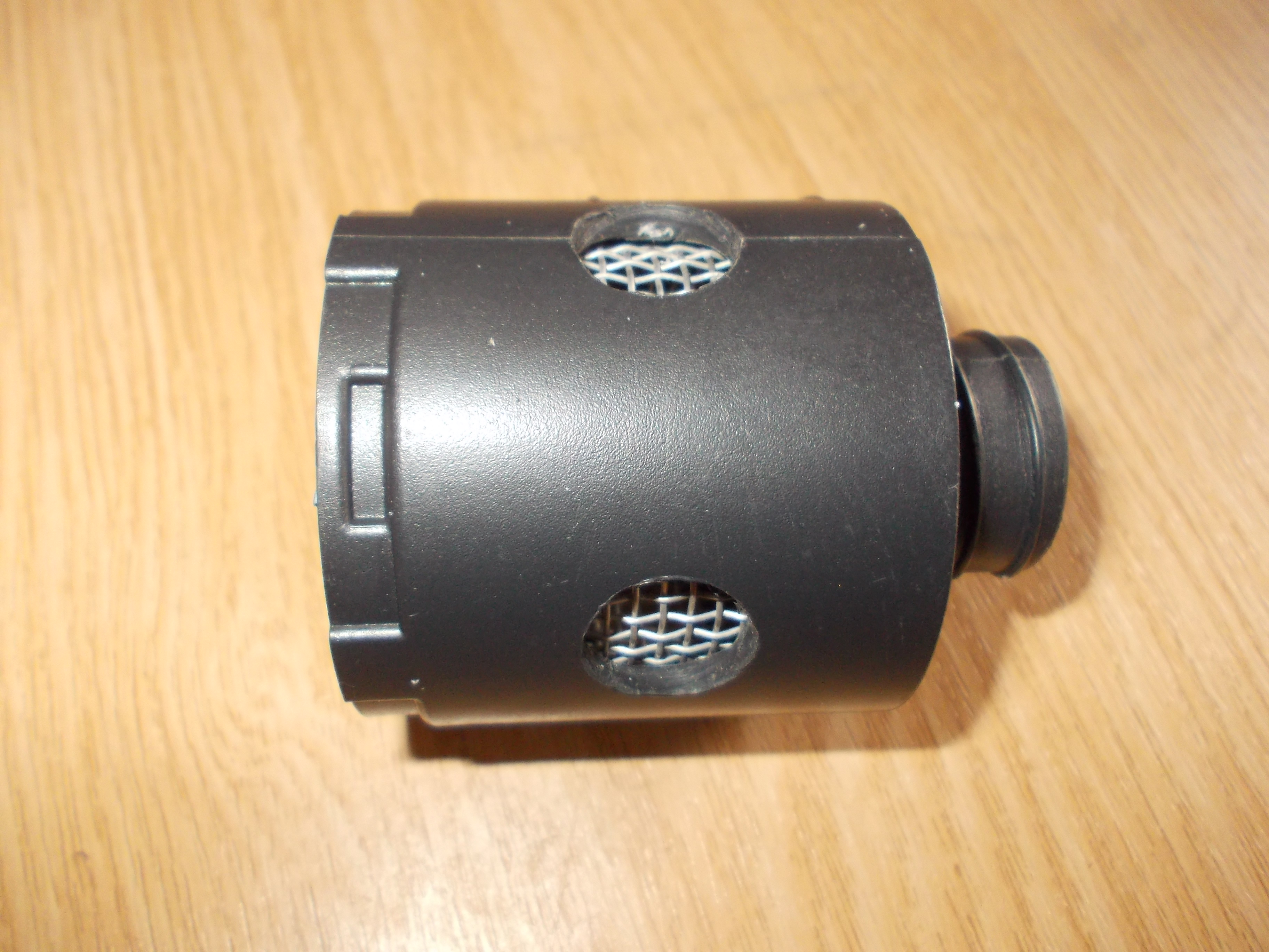

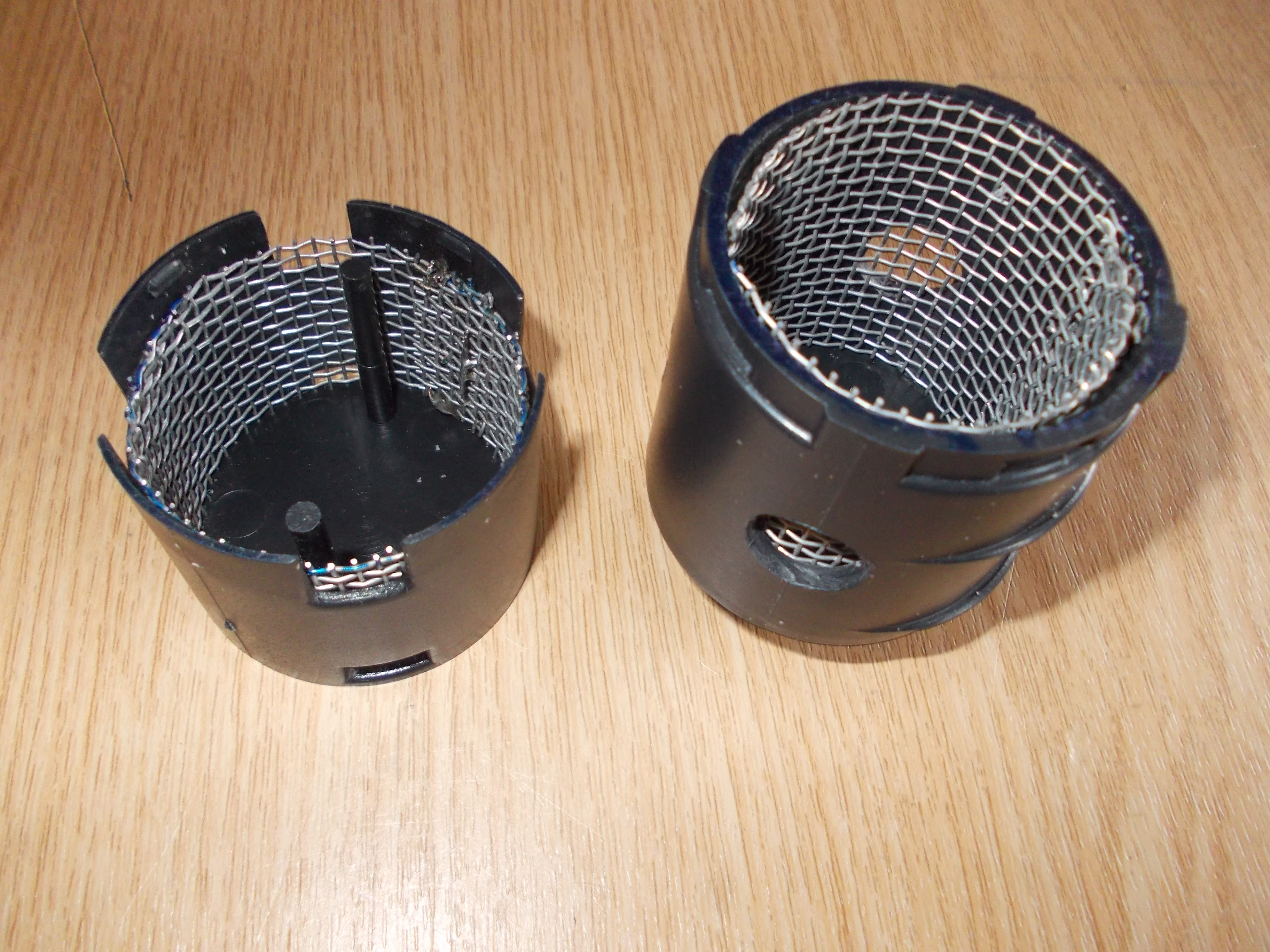

After our little conversation last night I decided it was time to find out what was actually inside this little tin box, do we really need to have it and is there another way we can get a better effect by using something else? Well here we have it taken apart; basically a shell, a spring and some sort of matting. After looking at this I thought wrapping the exhaust in exhaust bandage would probably do the same, or better.
Rae

The genuine eberspacher one has slightly different design BUT largely the same effect.....
I find I cant hear my heater running from beyond a metre away with genuine eberspacher inlet and exhaust silencers.
The chinglese intake silencers are hopeless some are barely more than a plastic tube...
You can run 2 exhaust silencers as long as you don't go daft with the length of tubing involved from heater to final ou

When I was looking at silencers there were four options: Eberspacher, Chinese straight through, Chinese kink (copy of Eberspacher) or motorcycle, where a spacer would have had to be made. The problem with the Eberspacher and it's Chinese clone is it slows the exhaust gasses down and that's why I've opted for the cheap Chinese straight through but really I think I should have just bought a length of exhaust bandage and lagged it twice. I think a yard and a half should be more than adequate as a length of pipe. The only problem I foresee now is on the inlet. I fully intend to run a cheap Chinese silencer and see how that works. I did even think about putting a conical shape filter on the end of the heater just to prevent large particles being pumped around the van........that's another job.
Rae
Rae
Take my word f
Rae
Take it from my own personal experience.... The chinglese silencers (inlet and exhaust)
Are miles away from the genuine items.
Interesting pics of the internals from you and Rae.
On a audio test, using Mk 1 ears, I found fitting the chinese silencers did have a noticable effect when fitted to the Inlet, and also to the Outlet pipes. Looking at the photos, I'm a bit surprised how much effect they did actually have!
I did try a pair on the exhaust pipe, after Alf suggested that was very effective, but I found while it seemed to change the tone, it didn't seem to make it any more quieter compared to just one. But I suspect now that may have been down to the two Chinese jobbies rather than the - probable - two Eberspacher ones Alf had used?
Making me curious about trying a genuine one now, but I have to say even these cheap Chinese ones ARE useful.
YES the chinglese exhaust silencers make a good difference (though I have to the the genuine ones even more so)
The Chinglese inlet ones generally need chucking straight in the bin...
I reckon close to 50% noise reduction (none scientific MK1 human ear) with a genuine eberspacher inlet silencer over a chinglese one.
Some VERY worthwhile reading on Lektons page (my go to no nonsense bible eberspacher wise)
On silencers
Not sure if I am familiar with the Chinese Inlet Silencers (unless by these you are meaning the end piece wirh the foam insert?). I am using the same style Silencer on both exhaust and inlet, with the foam and plastic end piece which is a debris catcher mainly I would say?
That website you linked to certainly is the business. Always been my first port of call for these heaters :)

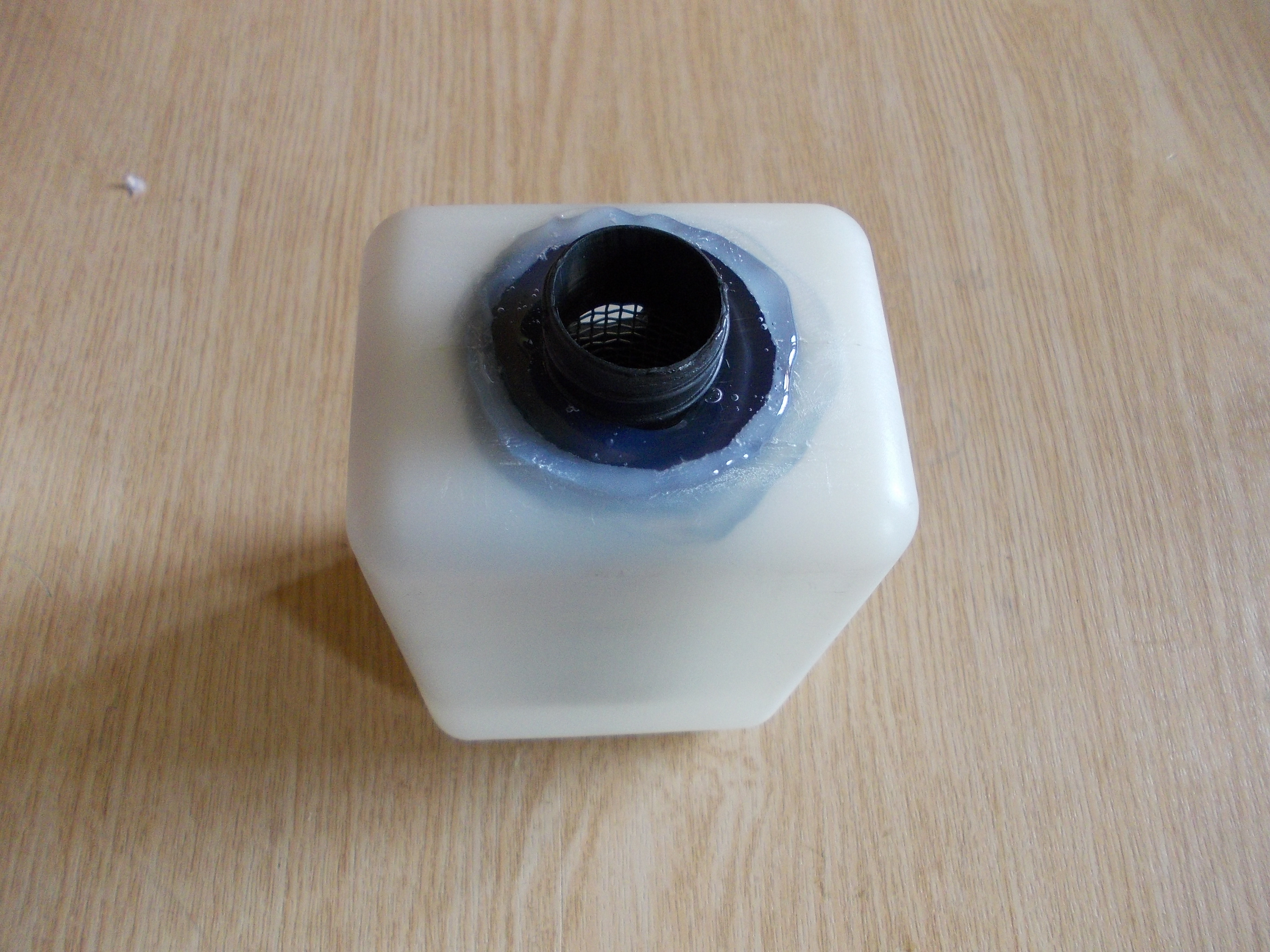

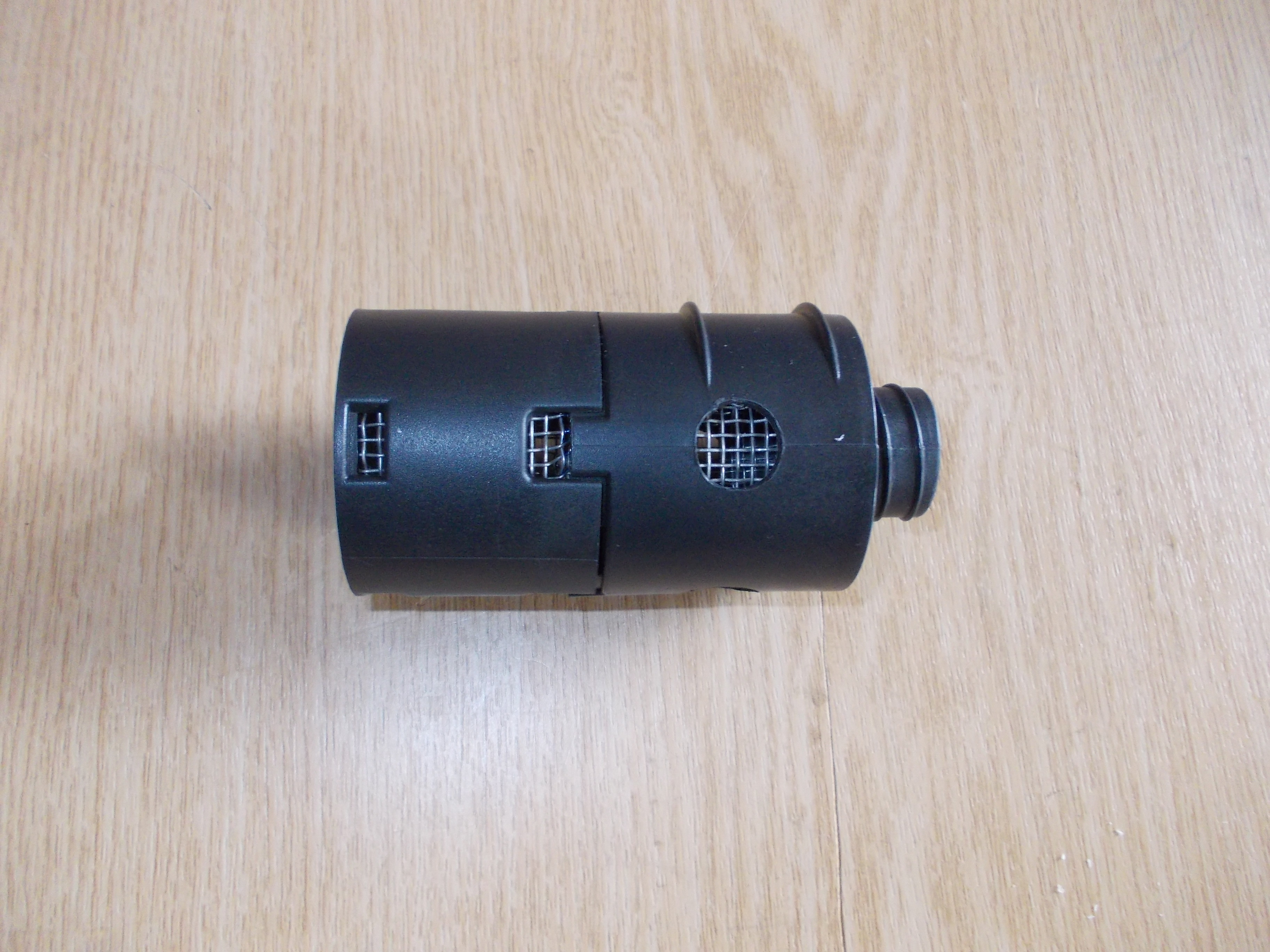

Decided to do some doctoring to the air filter.
First job: remove the foam and put some gauze in it's place.
While I was fitting the gauze I thought some extra holes wouldn't go amiss.
All together, ready to be glued.

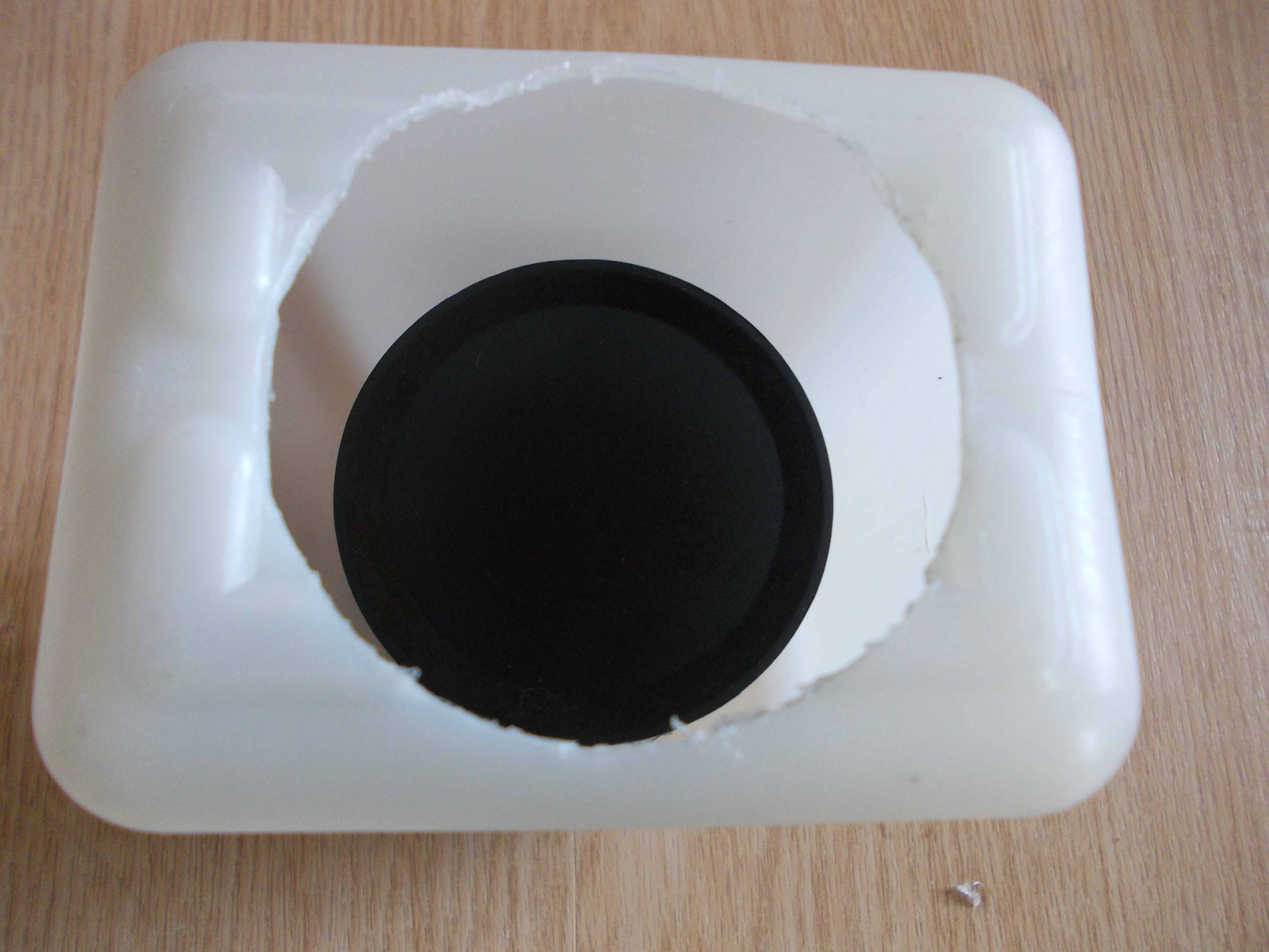

In my experience with air filters, once you take the lid off they become very noisy so I decided, in this case, we would try and encase it in a plastic bottle: basically, drill a hole one end so the filter can fit into it and saw the mouth of the bottle off.
With the aid of a glue gun it was just a matter of running a bead on the inside and then the same on the top.
Here we have it from the other end; loads of room for the air to circulate.
Rae

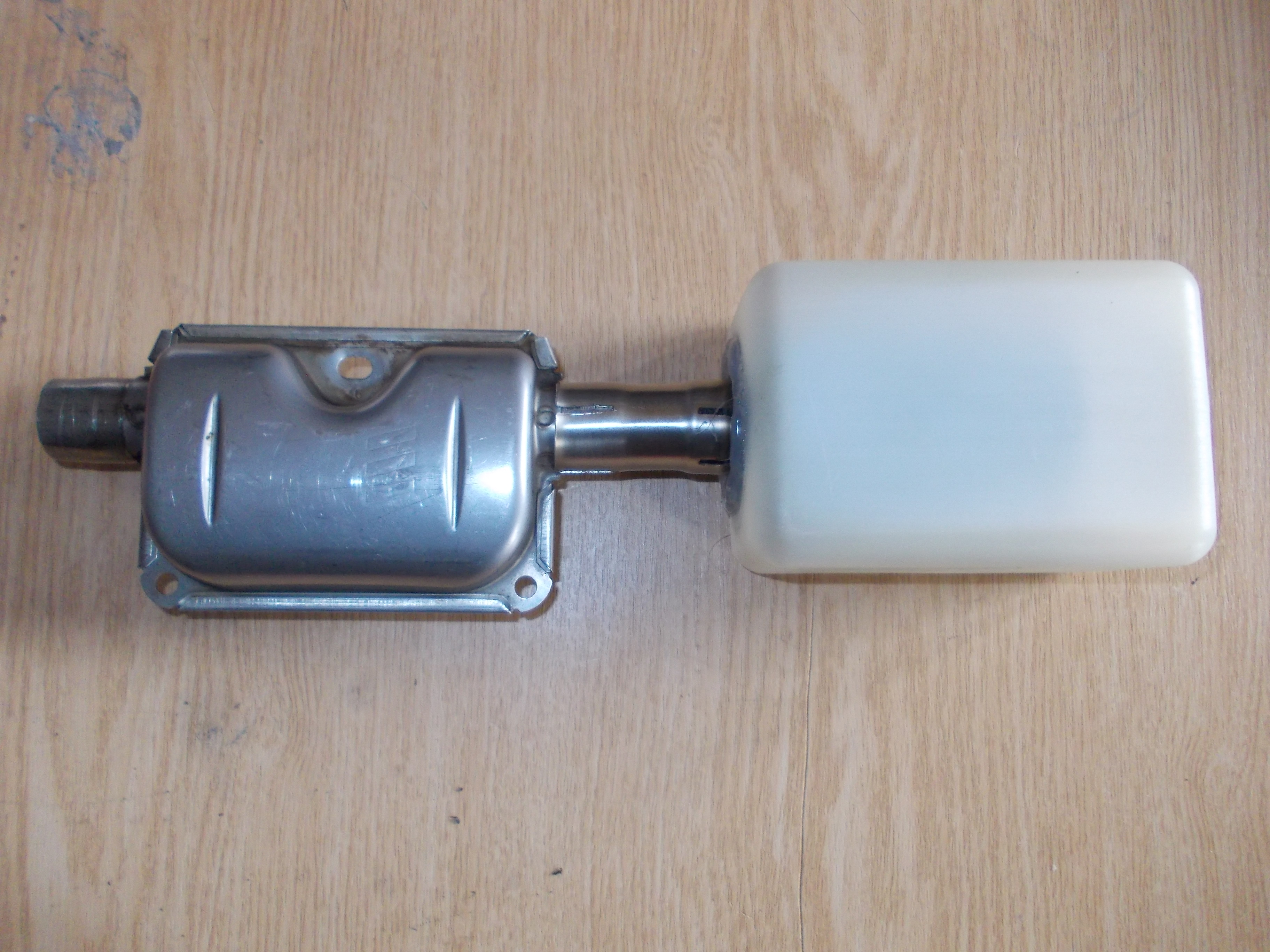

Coupling the bits together.
First job. I needed to expand the tube so it would fit over the air filter pipe; easy enough job, find a socket of the right external size and then knock the tube down over it.
Nice, neat fit. Now the other end.
Cut four slots in each end so that when the jubilee clip gets tightened the pipe will contract.
The finished job: inlet and exhaust........the exhaust was far simpler.
As some of you may have noticed, I have used a genuine Eberspacher silencer: the main reason being I had it laying about and, also, it should not have the problem of condensation so much on the intake.
Rae
