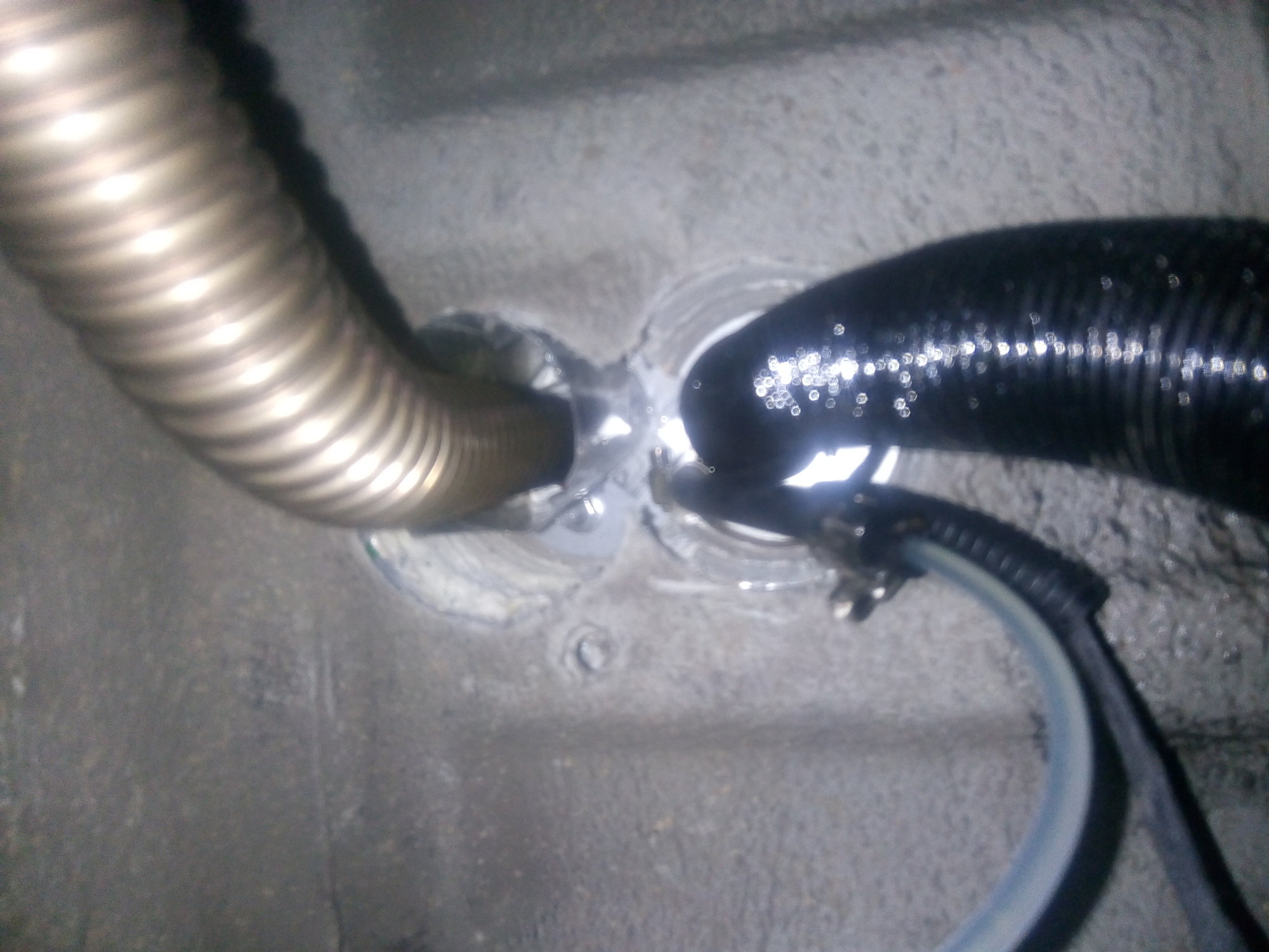

Hi everyone I have put a Chinese diesel heater it worked for 10 mins then stopped with error e-8 on screen. The exhaust silencer I side was black and dripping I stripped down the whole heater and the inside was caked in soot like it had been used for a year not ten mins, I cleaned it all up put it back together and it worked for another ten mins then the error code has come up and its stopped working again. Can anyone help with why

E 06 fan . The boarding is very tight fit around pust on for better fit.
E 08 filter not upright and pipe didn't reach the bottom of 5 litre can, so heated up on cooker took twist out of pipe that so now straight my first 12 inch.
