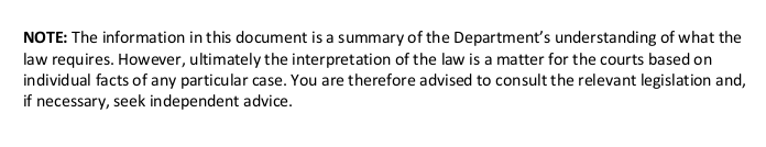

Thats it and for folk reading it,its a interpretation of law as it states at last page,so if you bed is not qt 6 feet it realy dont mater caus no one is going to come with a tape m,just make sure it looks right as in a proper job rather that a lash up that a schoolboy would do,and i have seen a few in my days.

I understand what you are saying,but here is the last page,i have seen many a few inches short of requirements.

Yes but the last page says ' ultimately the interpretation of the law is a matter for the courts based on individual facts' and as I mentioned I wouldn't want to go down the route of what would be an extremely expensive court case with no guarantee of winning.
I am only advising that sticking to the published minimum requirements will prevent a possible disastrous situation of having an
application turned down on something like bed size but if converters want to take the risk then it is up to them.
