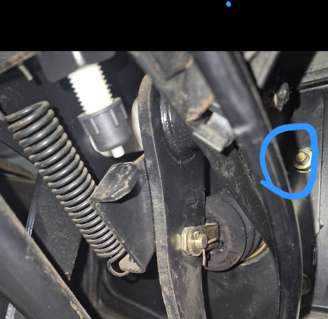

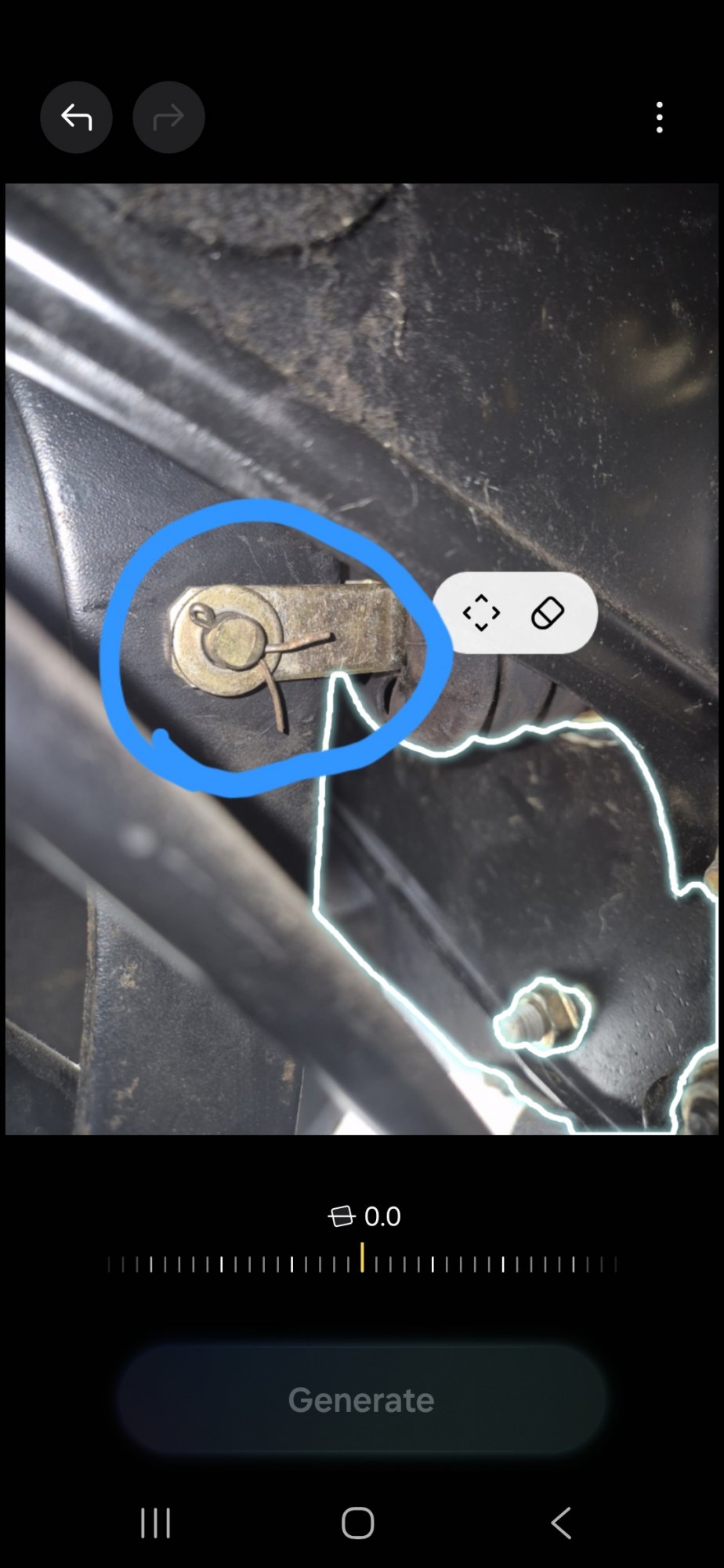

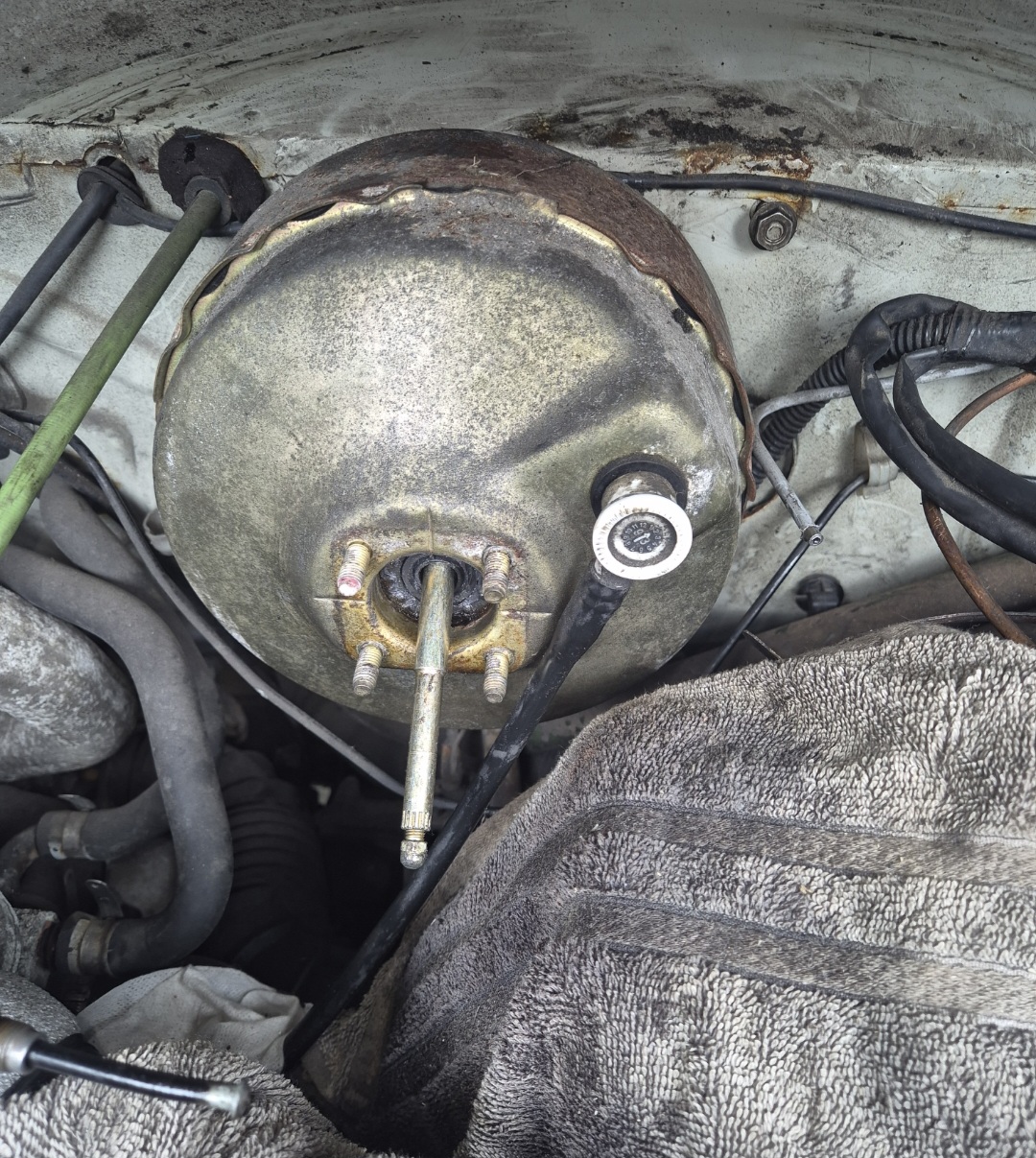

So it looks like I will have to cancel my holiday to Cornwall in August..was travelling down from Yorkshire. But hit a snag .it seems my brake servo has decided to pack in .as they dont make these anymore I need to remove it and send it away for repair ..trouble is everyone is mowed out .that aside I have removed the master cylinder .removed the pedal.linkage .pin and removed the four bolts on the inside of the cab under the steering wheel by the brake pedal..the thing still feels.pretty solid and is not budging ??any ideas am I missing anything ( 1994 fiat ducato bymer b534)
Or is it just rusted onto bulkhead in engine bay .thanks in advance

I'm pretty sure its a case of master cylinder off ( done )
Undo.split pin and pin that goes through pedal ( cab side )done )
Remove the four nuts from.the four bolts by the foot pedal.( done )
I thought it would then pull out in engine bay
But no such luck..
Gutted
Thanks again for reply appreciated
They sometimes get stuck to the bulkhead I think you have done all correctly you might need to be a bit brutal to remove after all them years
Cheers scared of damaging the bulkhead. I will try soak some penetrating oil down back of it .i thought hang on have i missed aomething here its stull tight on😂 .thanks for reply much appreciated

Thanks 👍👍realised this has double nuts one ot behind pedal plate bolts through where pedal plate is so need to remove all the pedals and pedal plate to access the remaining nuts .and the steering column is in way too 😂

Its out .I will take a look later today .though I may have found one in Italy. Maybe best idea was to tey get mine fixed but had to gamble as everywhere seems booked up.for repairing them

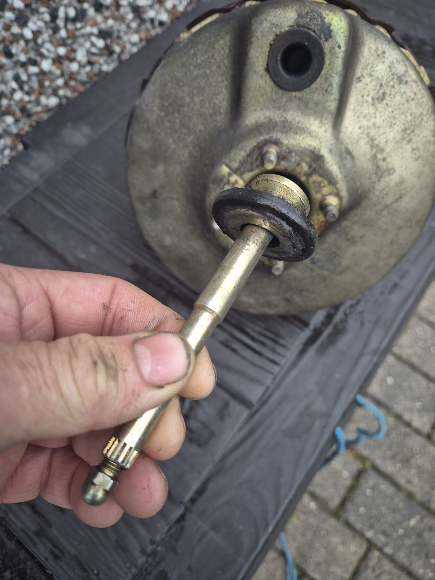

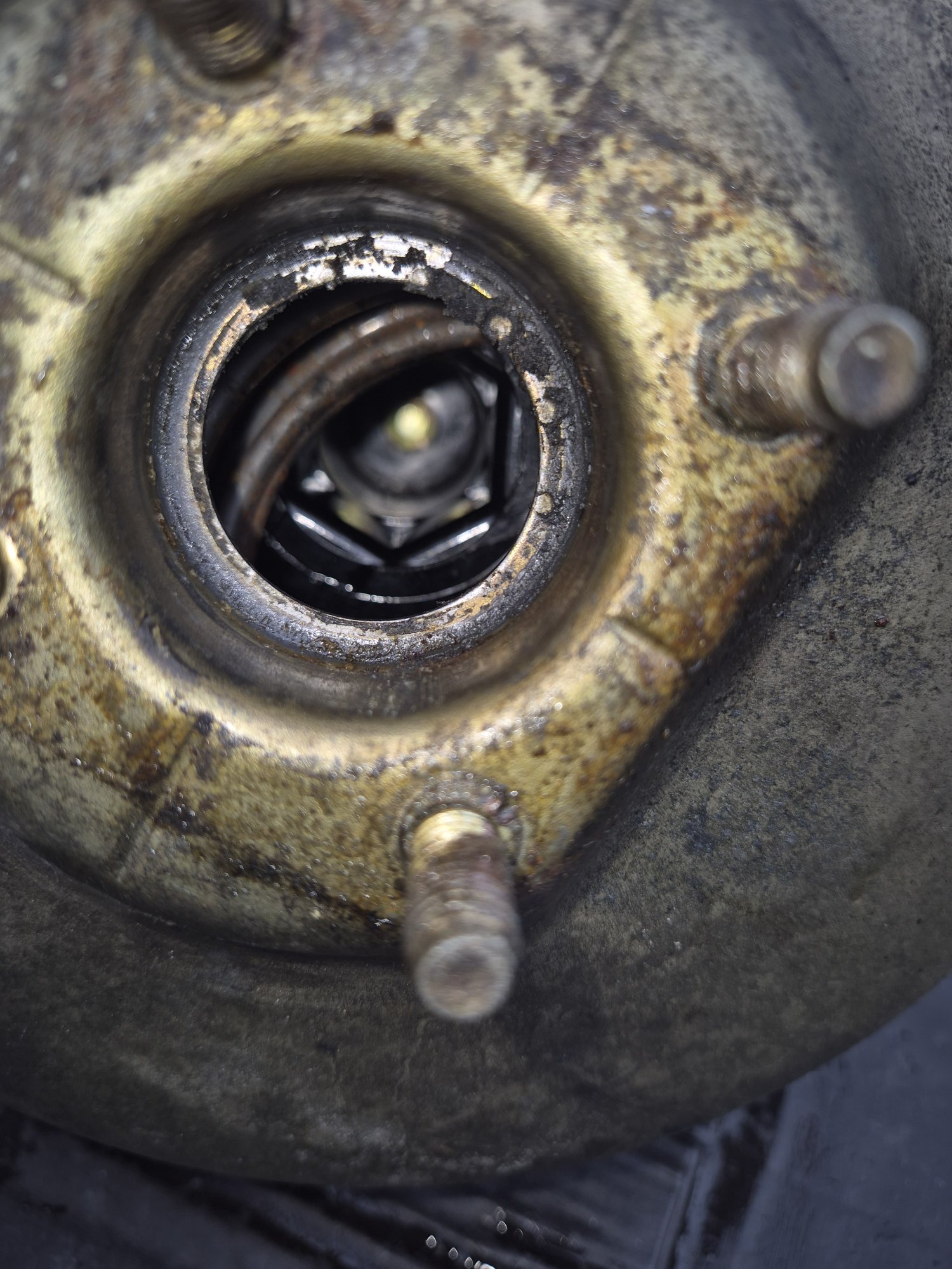

Its out !!I'm guessing thie plunger that gets pushed inside the brake master cylinder shouldn't wobble about side to side or drop out easy like it did
