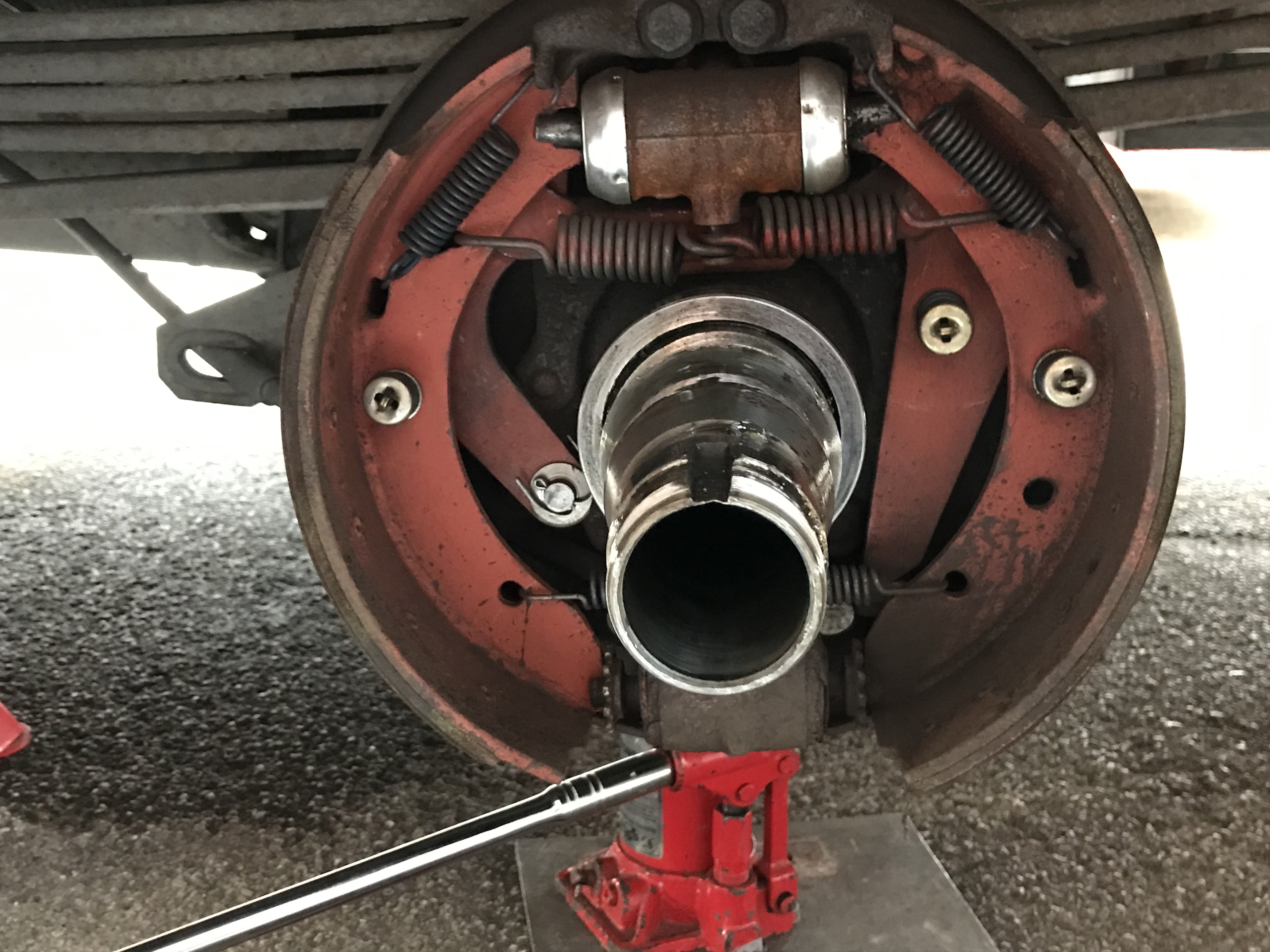

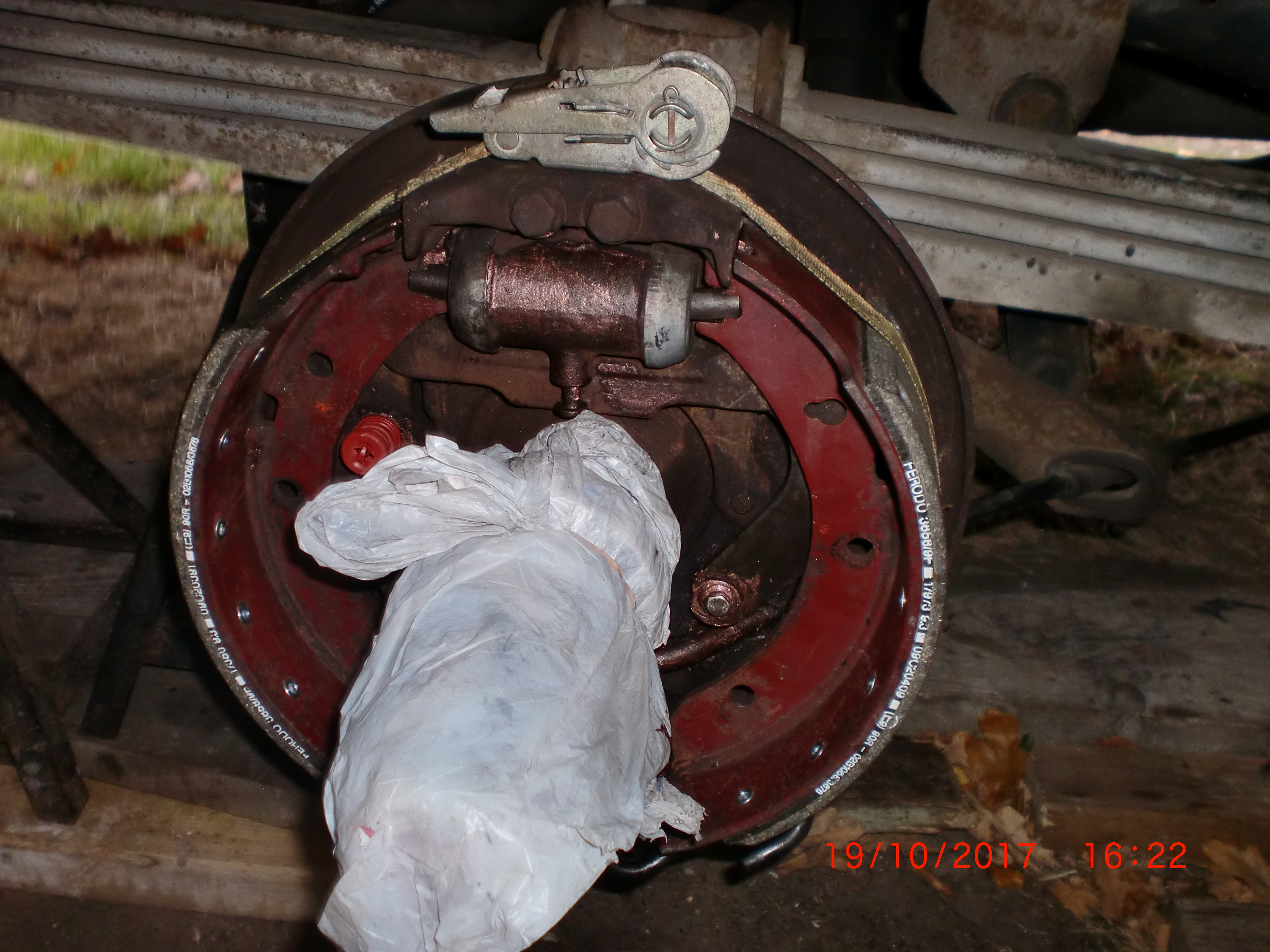

The brake pic shows though how old tech isn't always a plus when you DIY, I'd much prefer the later Vario disc
brake setup. Rear drum,s & no ready mades available, so had to rivet new shoes (steel rivets! not soft copper) &
the drum is integral with hub so special tool required for the axle nuts, couldn't source so had to fabricate and weld
up my own.

You should have dropped in earlier, I currently run a 811D. I've been running this one for a very long time and I had two 608D's before that.
Hardest thing to get is gearboxes, most of the other stuff is easy. Brake shoes no problem either. With commercials, it's common place to reline them. My works offer that service. Just keep that rust under control, that's the killer.

'Dropped in', like 30 years ago lol. I could indeed have got someone to reline the brakes. However, I treat
the van as a hobby/challenges, per se to DIY as much as practicably possible. So far it's never needed
the services of anyone other than myself and Mr. MOT tester of course.

I replaced some steel brake line sections with Kunifer, more preventive maintenance than actual necessity, but
I get to fairly remote places, particularly Morocco most years and never have any breakdown recovery
insurance.
I found the eBay Chinese brake piston wind back kit to be useful for getting a recalcitrant caliper piston back
where it should be, better than a couple of wood blocks at least.

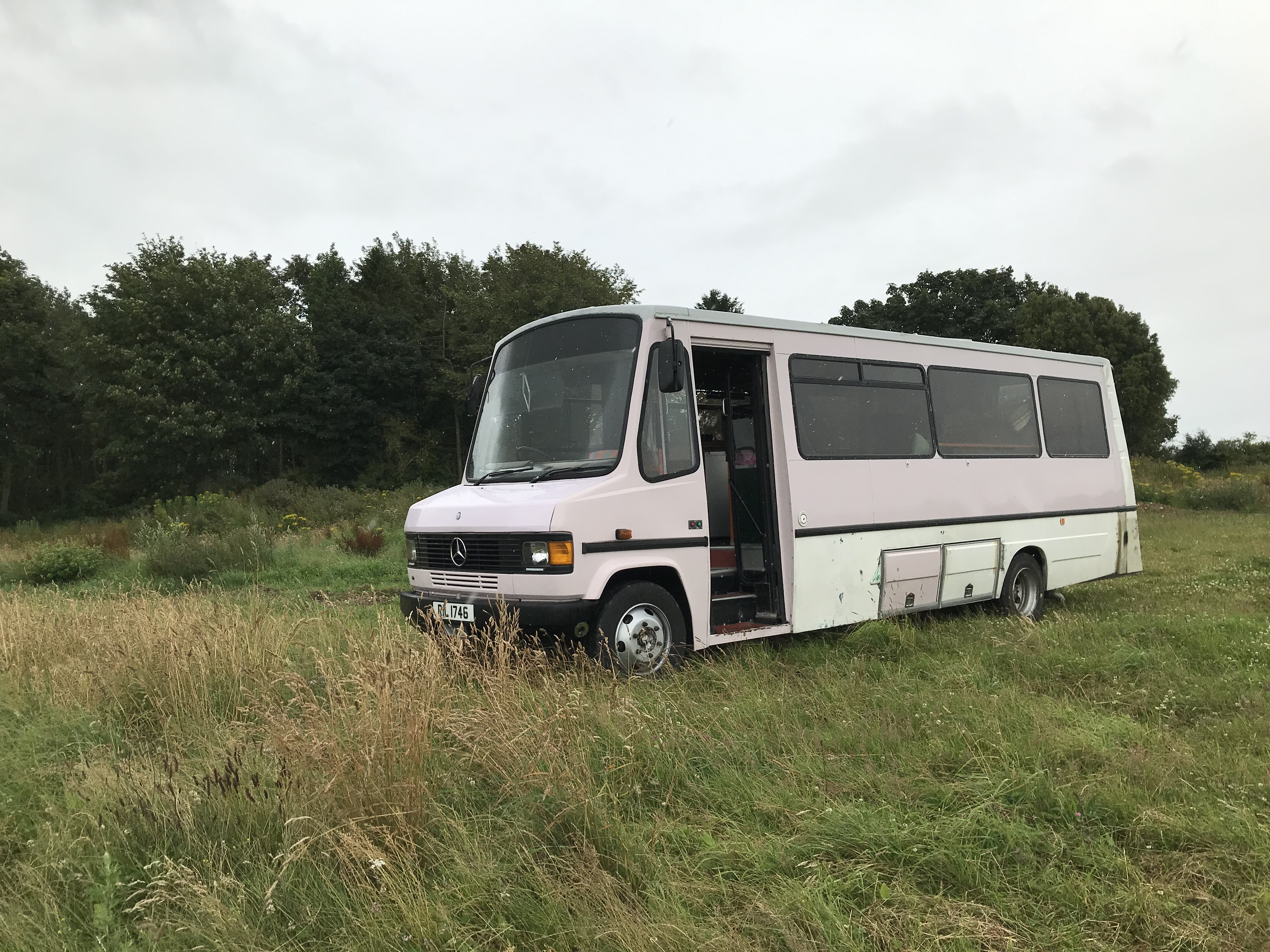

This is our odd tart.
