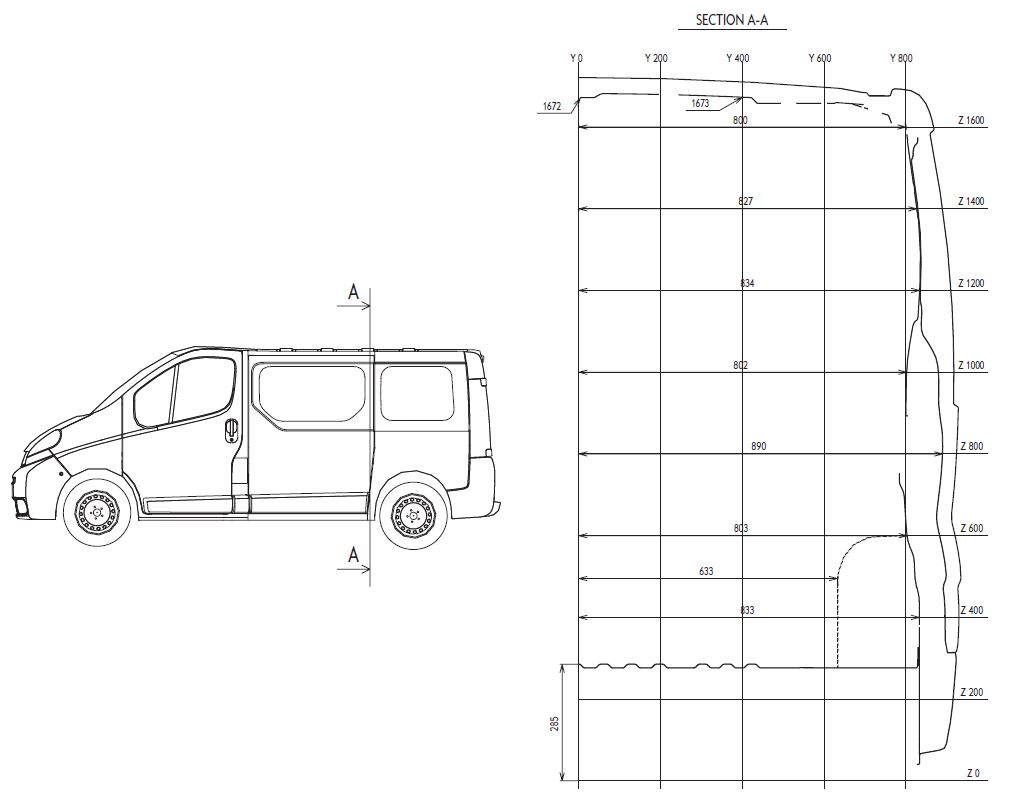

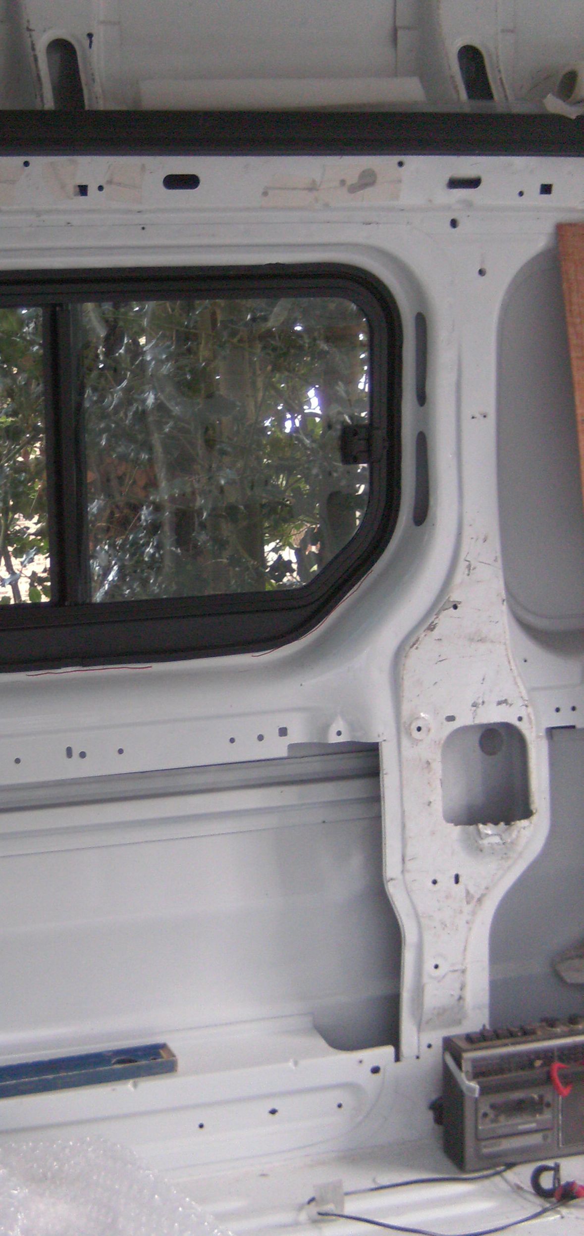

Trafic, Vivaro and Primastar are similar, the wall profile bends in and out. Tightest spot width ways (1570mm) is at the C pillar where the fixing for part of the rear seat belt mounting (minibus and crew cab versions) intrudes. I bent and hammered back as far as possible in my van but the C pillar itself narrows the width down to1585mm.

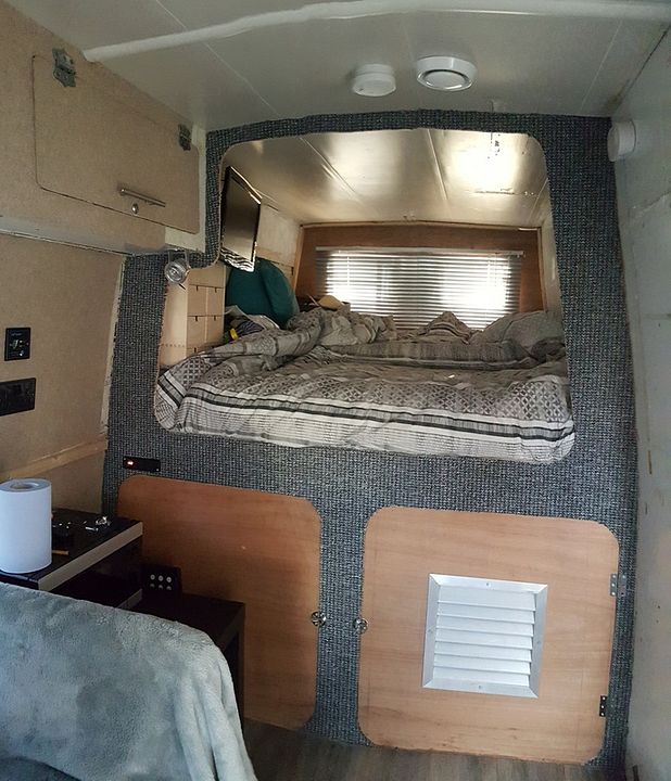

Same here transverse bed is frankly a pain with it always seeming to be that one has to camber over the other to get out...
It's why I built the one in our old transit lengthways to take a decent double mattress.
Much more practical in many ways than the over cab transverse in our current motorhome. View attachment 204240

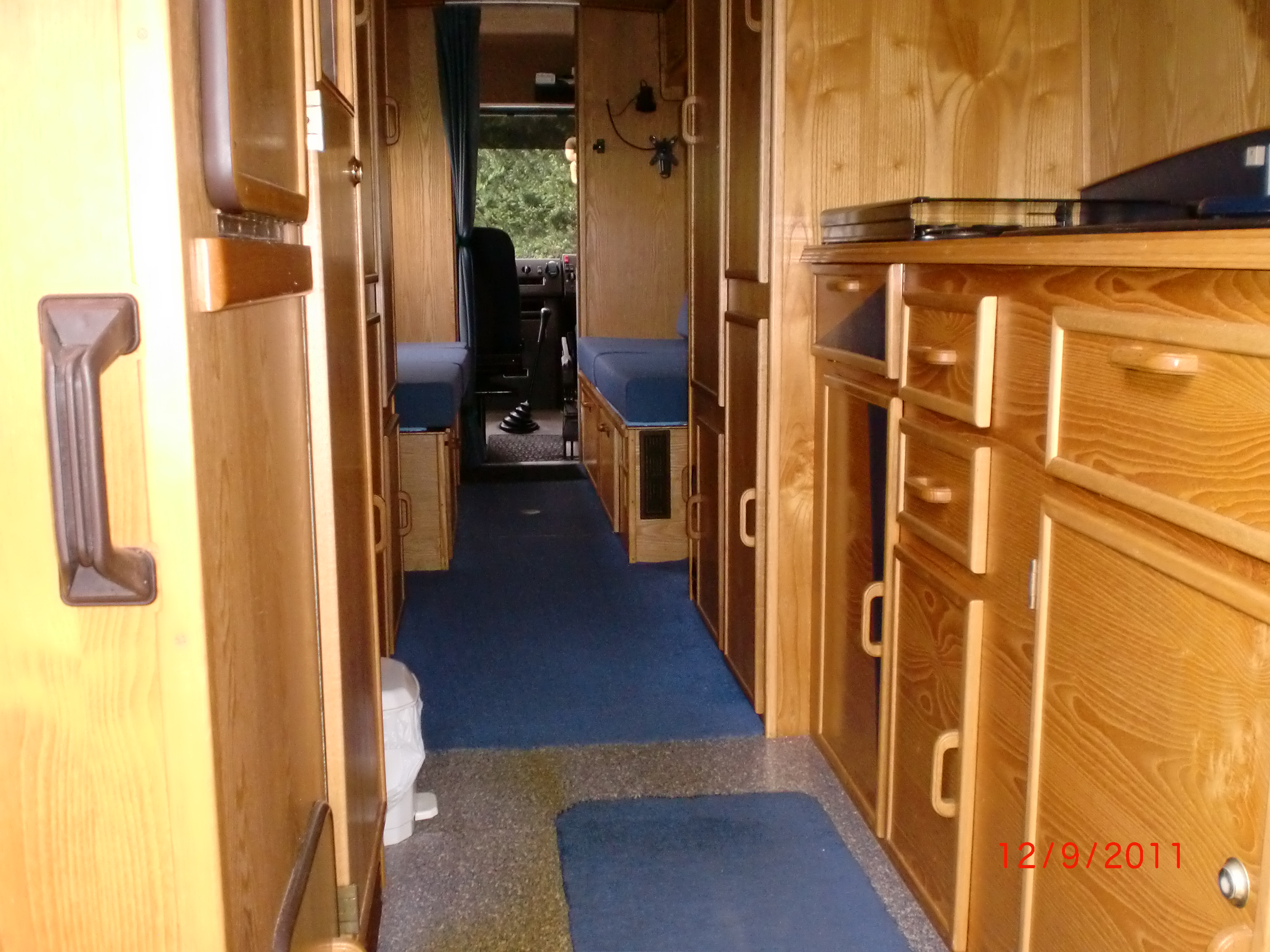

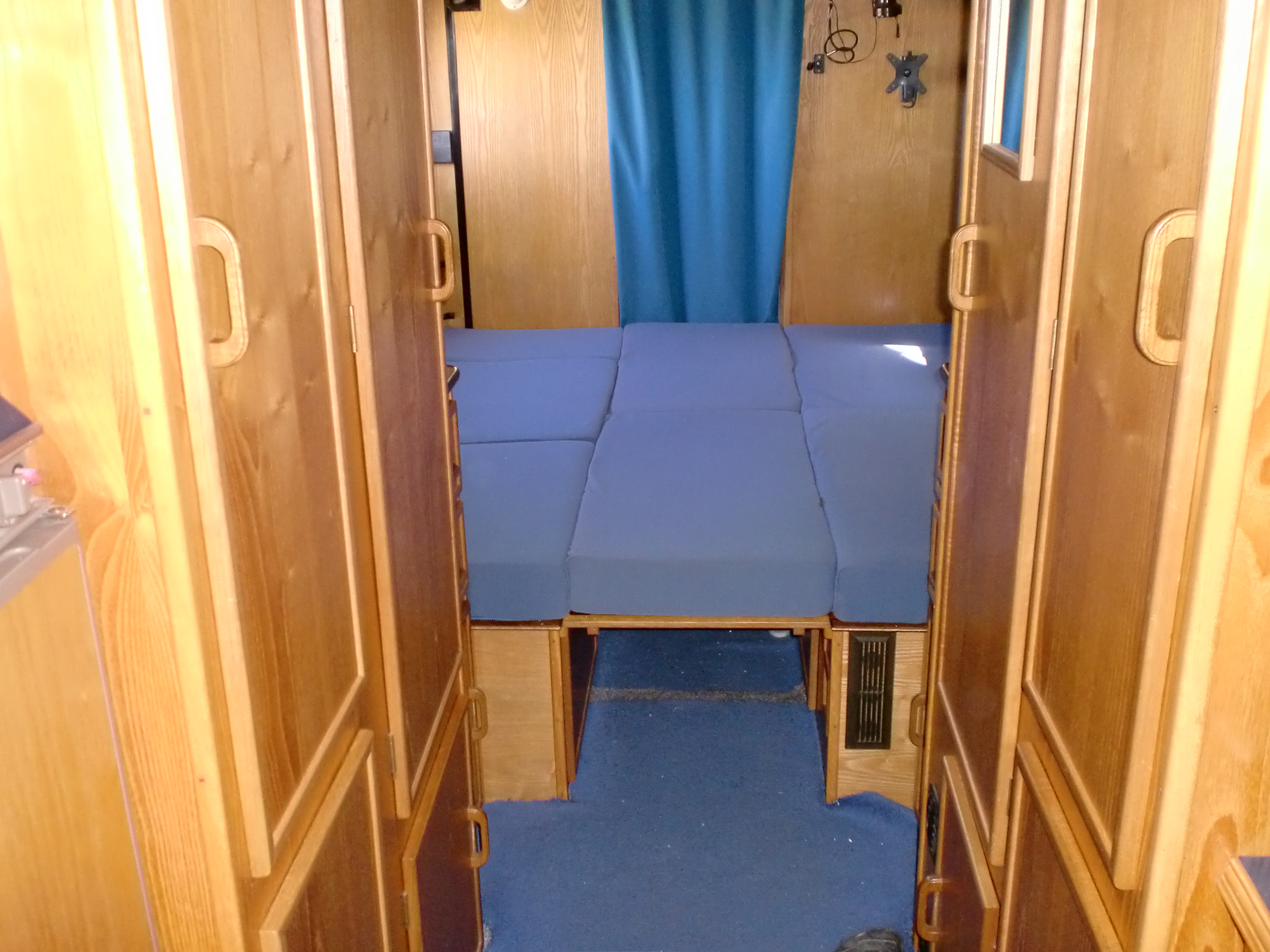

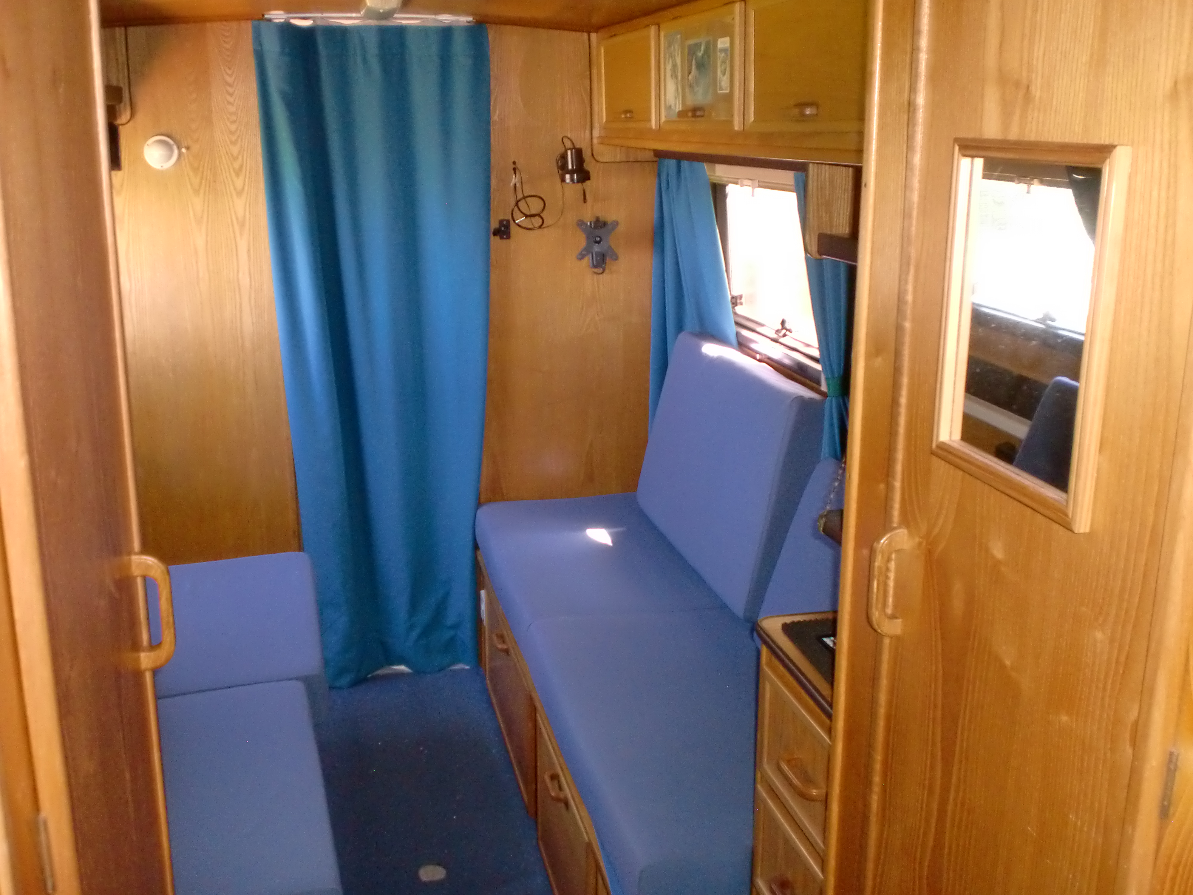

I've owned the same van for about 27 years (MB Vario type PVC). Over the years I've had to adapt the interior
to suit changing requirements. Originally it was rear transverse bed over garage for large m/bike, then it was
2 singles at rear with light M/bike on rear rack.
Now it's front single beds, which after a fair bit of faff can be made into a double. A heavy price to pay so as
to maintain rear barn door access and still carry M/bike on the rack.
Thankful that I constructed the van interior to be relatively easy to rearrange, kind of modular construction,
at least that's what I call it.
at least that's what I call it.View attachment 204247View attachment 204248View attachment 204249
Any piccys of the van? Really like Varios
