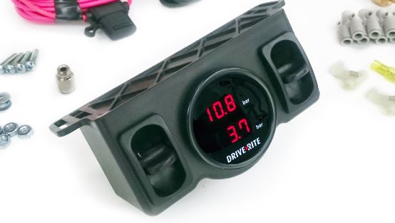

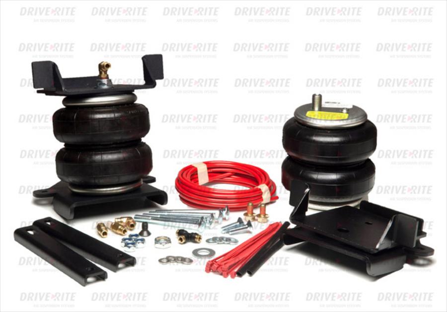

Interestingly when I was at the Motorhome show yesterday I came across a Couple of providers of Air ride systems
One of them has quoted me already for a system to use on the rear of the new Merc coming in at just shy of £1,000
glide-rite.com
So just wondering if anyone is using any air or semi-air type systems on their Vans ?

People who buy the ambulances with air suspension rip it out and put leaf springs in. Massive problems with leaks, just not worth the hassle. Probably ok for a few years until things start to perish.

Think tech has improved, they have a 5 year warranty on the air-bag, guarantee against leaks and I would likely flip the van within 5 years. So with the improvement in ride quality and also the option for some levelling I would think they could be a good investment

I think there is a low-cost system for the Sprinter sub 3.5t models for just a couple of hundred quid? have a search around and you might find it (think it was on eBay I saw it following a comment on one of the forums).
There is also a product that seems popular in the US and is available here as well - "Sumo Springs". Think they are some kind of assister?

No idea how much it cost as it was installed when I got the van but mine has AS rear air suspension/air assist. Twin gauges and twin bleed valves in the cab along with compressor switch so everything can be done from drivers seat. I was in touch with AS last year when I asked about correct pressure settings and they informed me the system was fitted in 2007. Still working perfectly.
Edit: My van was uprated from 3.8 to 4t
