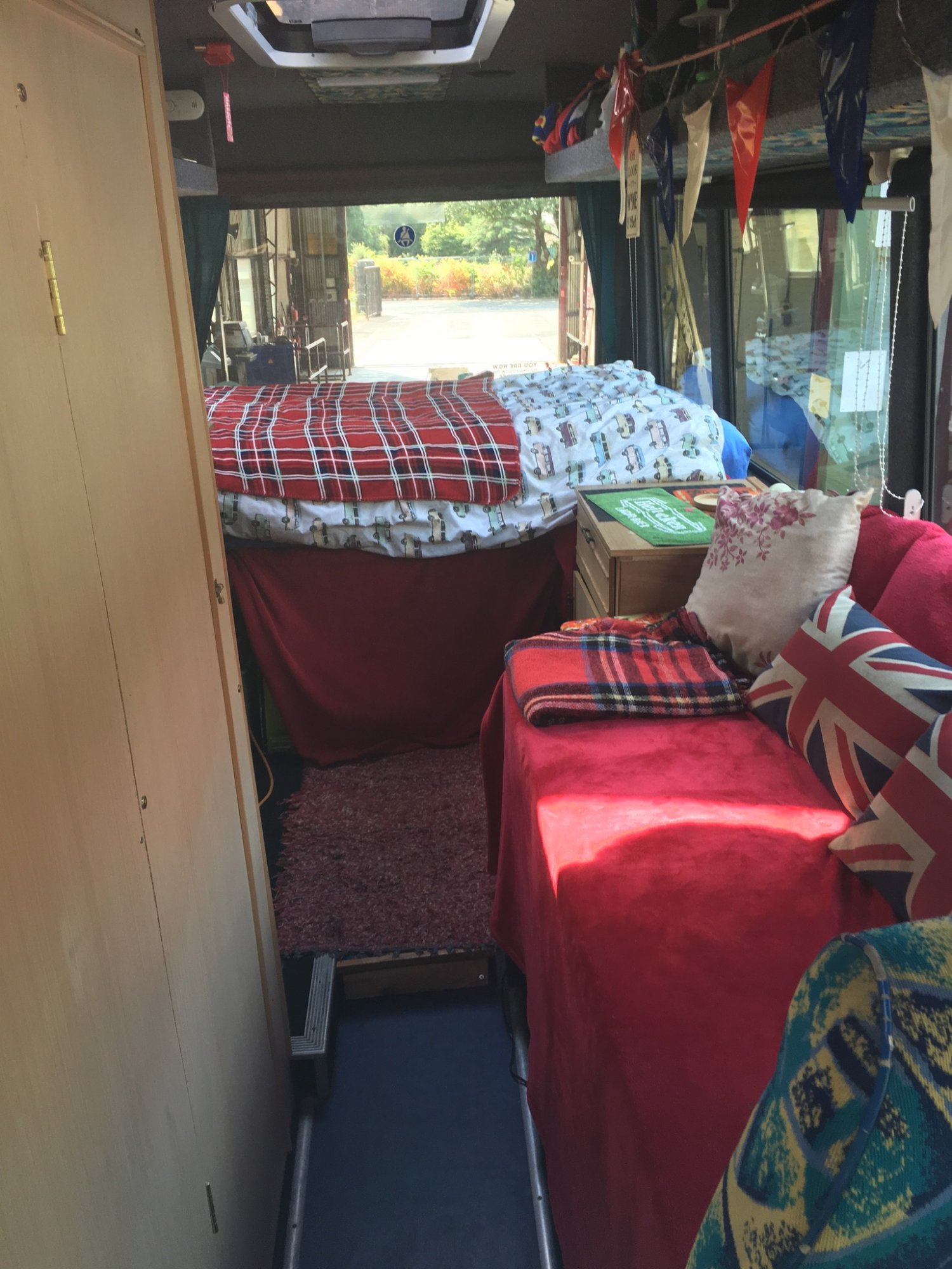

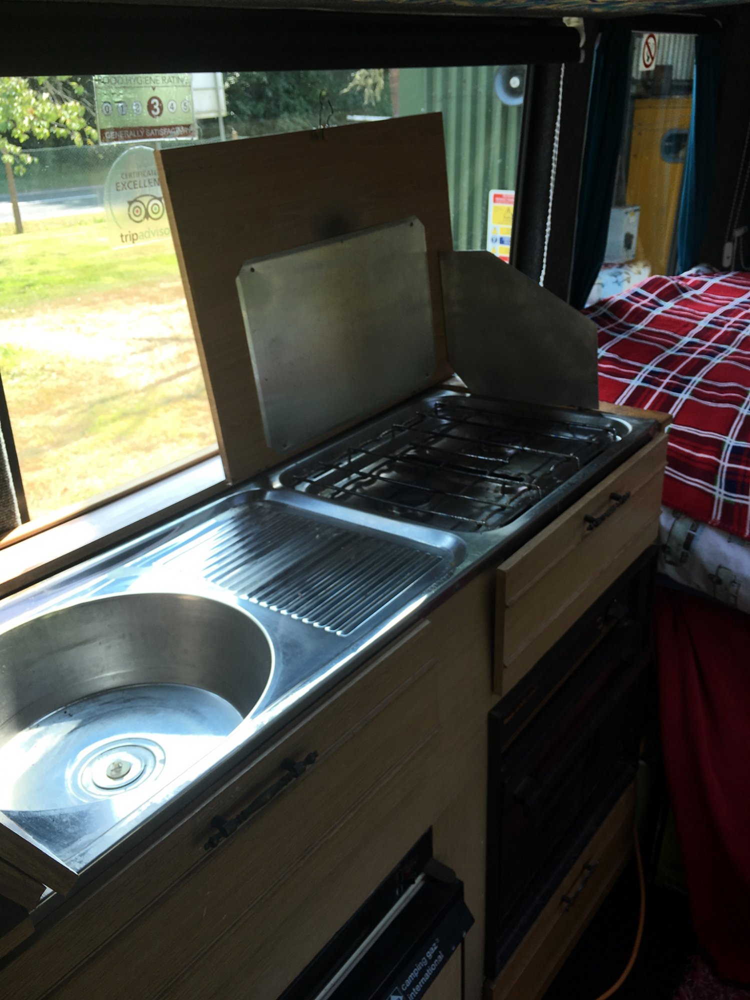

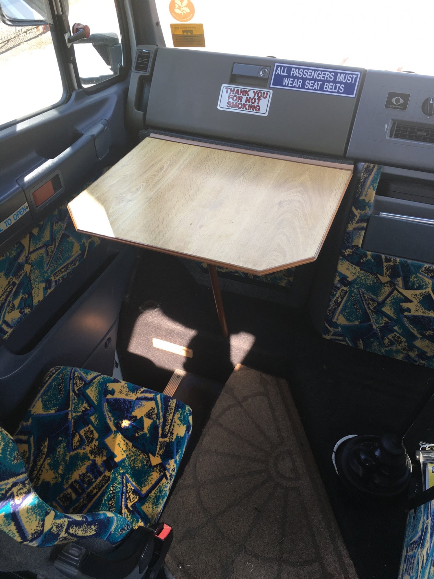

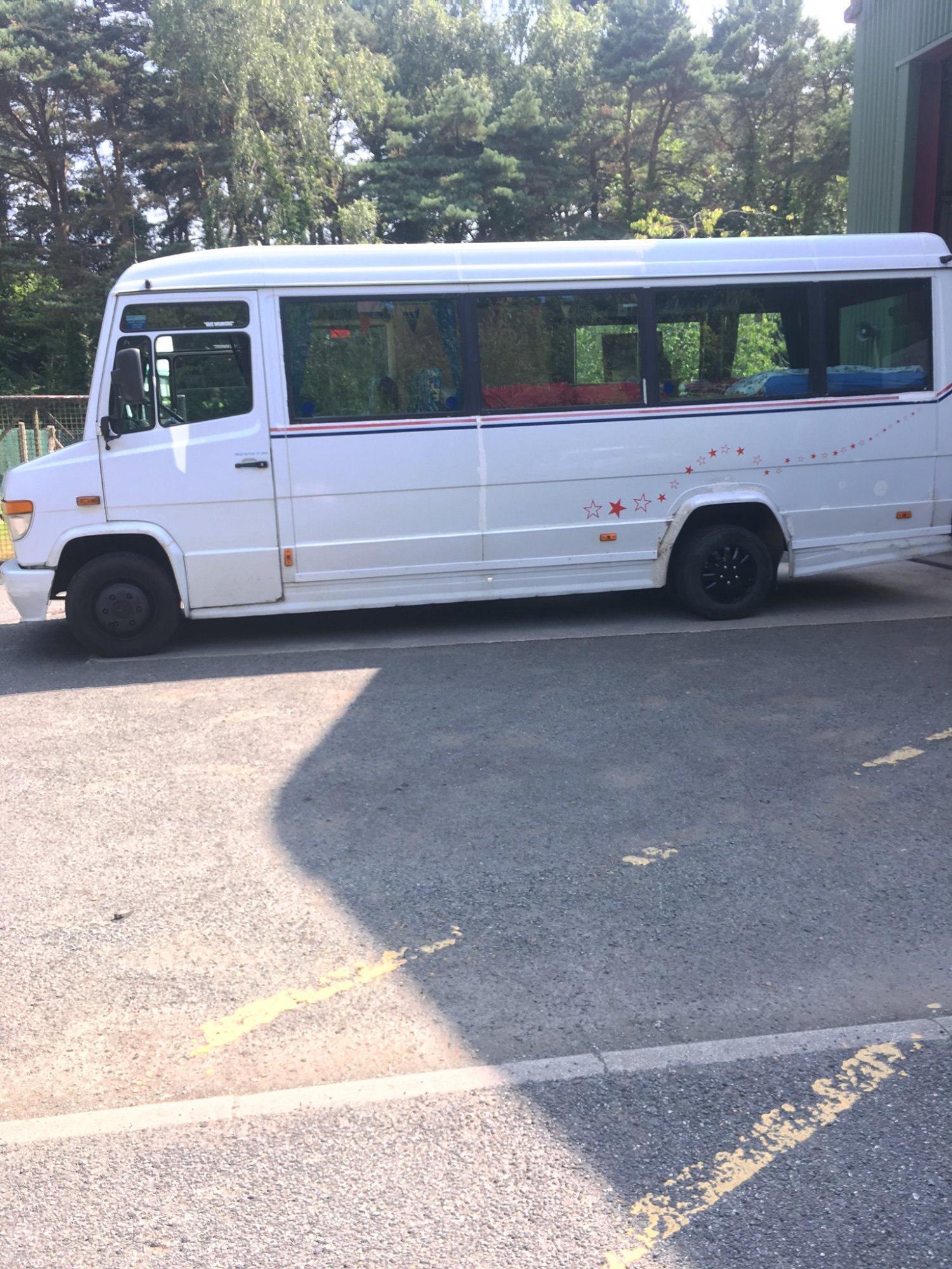

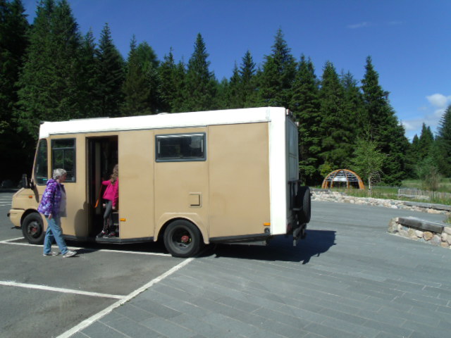

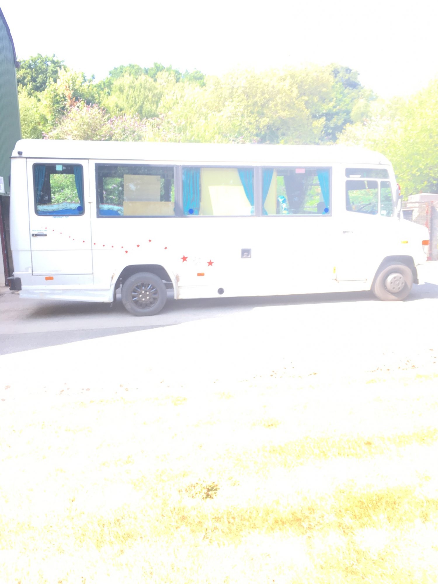

All done and registered as motor caravan about 3 years ago . Cheap tax (£165) from memory. Total cost approximately £2000 includes bus. Pretty sure with windows and all the other necessary features you should be ok 👍

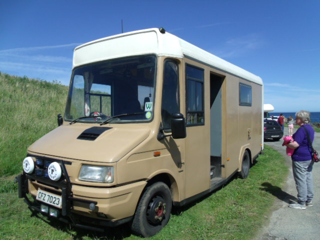

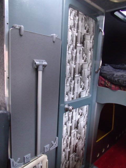

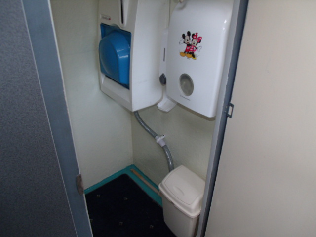

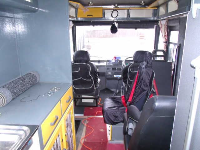

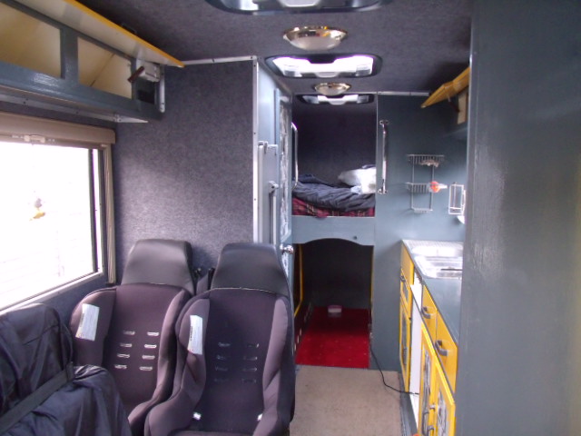

Nop min is motorcaravn on l book and in as phg as its 6.4 on the log book though in fact it weighs 4.3 allowing a 2 ton trailer if I wish, its also tested as a car but because of weight it has a smoke test done, bit silly as same engine in sub 3.5 vans which don't get exh test.forward from beds.jpgtable toilet door.jpgvan to back.jpgwash room.jpgabby rian van 7 20.jpgview point b.jpgdarva d.jpg
