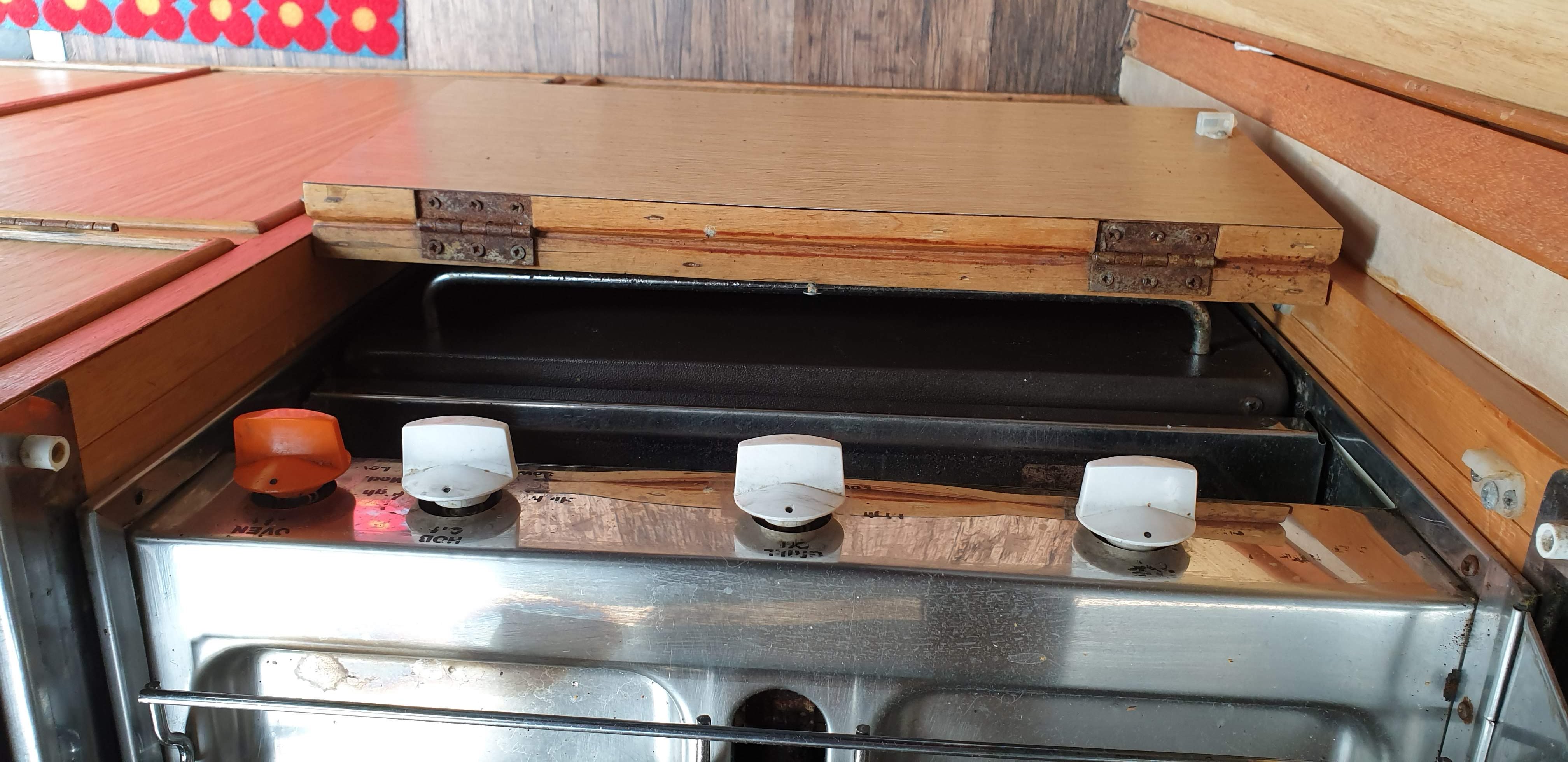

I have a small Gas Stove from the old tent Camping Days so will get it out of Moth Balls, do you reckon it's better than boiling the kettle off of the hobs I have in the Talbot (below)?
Bit of an odd view on this image but only one I have to hand
